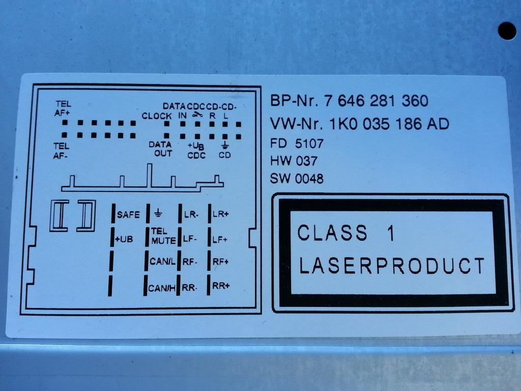

ah that makes sense, i took a photo of the sticker on the radio itself....
although i only remember seeing two connectors in the big block?

We're starting to get to the limits of my knowledge now but the aux connects to some of the pins in the top right hand part of the picture. Unfortunately the sticker only labels the CD pins not the aux pins. I don't know whether this means your radio can't take an aux connection or whether it is just that they haven't been labelled. You'll have to rely on someone else's experience for this.
