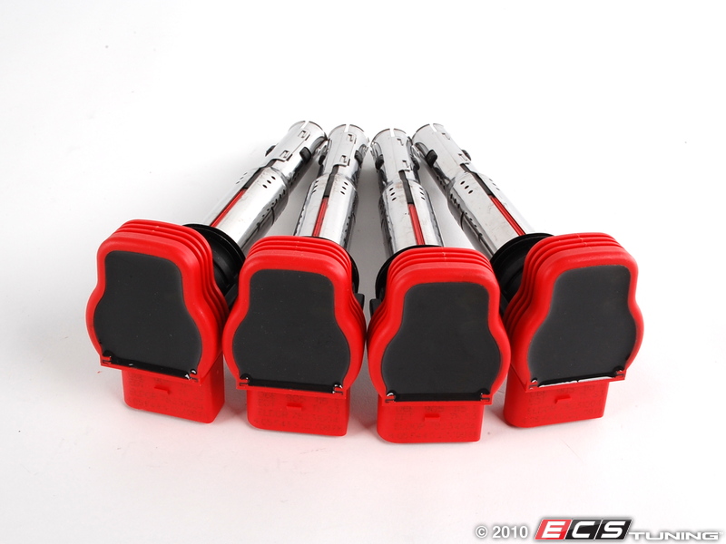

Offline Scottymon
  • -Given: 83
  • -Receive: 125
  • Posts: 2139
  • UnNaturally Aspirated
Re: Which coil pack do I need?
« Reply #4 on: April 14, 2013, 11:58:03 pm »
Grab some RS4 ones:
