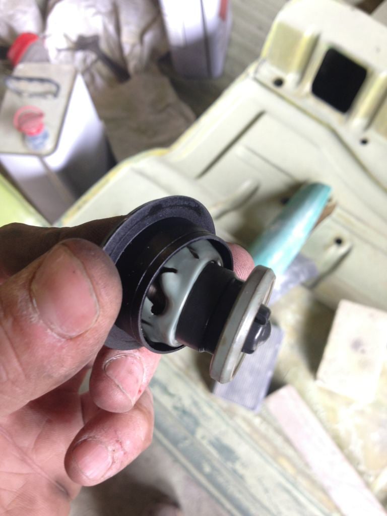

Well replace my DV today aswell as some boost pipe seals, this is what the valve was like so please a looked Ito this!
I'm surprised at the difference, it's not just better than before I noticed the noise it's better than ever. A lot better throttle response and the car takes off now it's like having a new car :)
