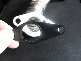

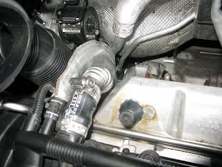

The rear pcv pipe is attached between this rubber hose and your turbo. It's a bit of a bugg*r to change without dropping one of the bolts that attaches the pcv tube to the turbo inlet. You will also need a new oem hose clamp or you can use a jubilee clip like in the pic below.
P/n for latest rear pcv pipe with check valve is 06F103215B
It may be cheaper (probably) to buy the full kit like from http://www.awesomegti.com/car/vw/golfmk5/ecs-oem-breather-update-kit-mk5-gti-pas-b6-jetta-2-0t but that kit seems to not include the rear metal gasket that fits between the turbo and rear pcv pipe p/n 06F 145 757 F
