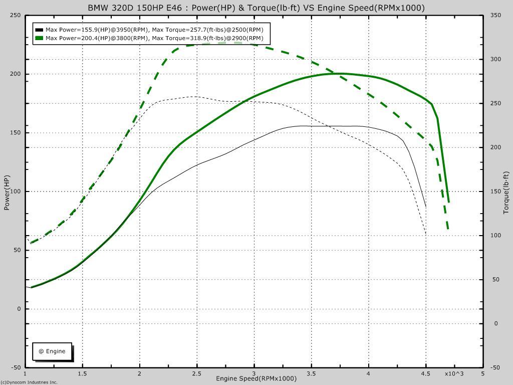

Ecotune in Hillington are the only place to take your 320d.
In regards to the tuning i shall let the dyno graphs do the talking.
These are availble to view on Ecotune facebook.
First is a copy of a 320d graph software only.

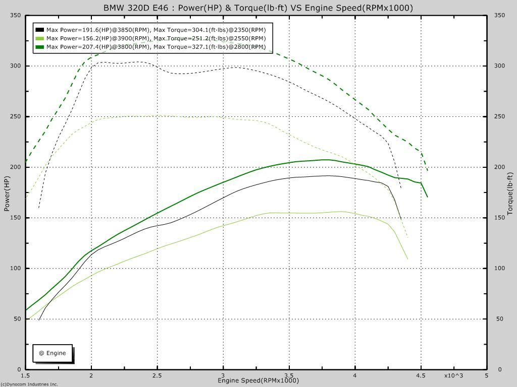

The second graph was a customer complained of flat spots and smoke. On that graph the original file was flashed for diagnostics then a tuned file was applied. Both the competitor file and the ecotune file included the application of a Ecotune downpipe which highlights the gains possible from hardware. The ecotune downpipe was developed along with the software.
