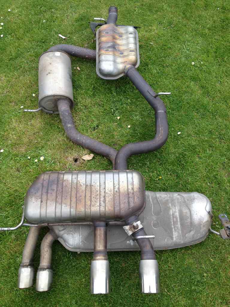

I was just about to ask if R32 exhausts would fit a golf mk6 with R valance.
Lots of R32 exhausts for cheap but nearly no mk6 R ones.
Physical differences are below:
MK6 R
MK5 R32
Recently back on the forum! Good to be back

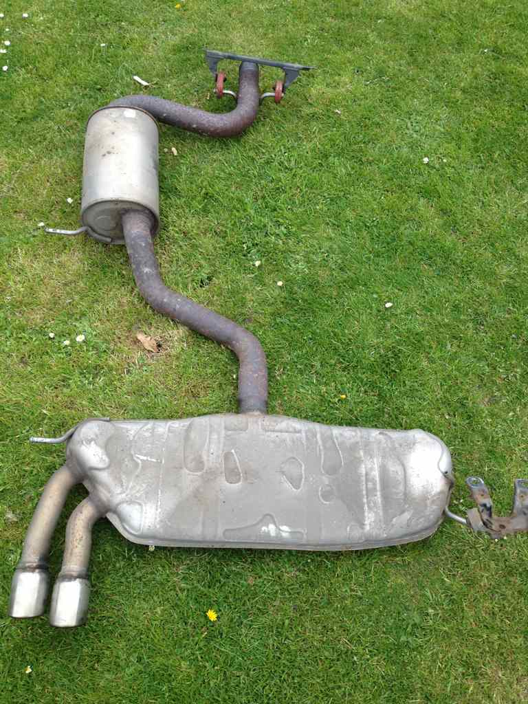

As far as I can tell, having not taken measurements I think they should fit.
However, I dont think the mounts for the backbox will line up due to the 4wd system so the backbox is smaller. So itll need modding im sure!

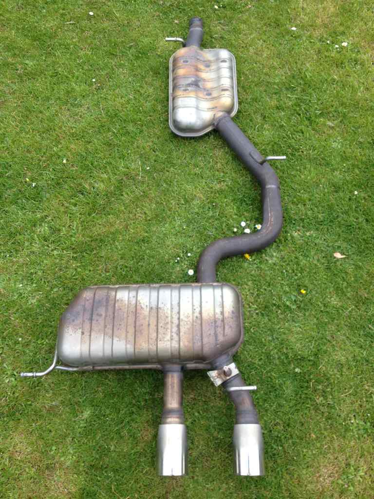

I've just tried fitting a mk5 r32 back box on my mk5 gti but the suitcase box is was too big to fit under the car? Does the r32 have a shallow spare wheel well or something?
Differences in pipe work

As I said the 4wd system means the pipework takes a different route and backbox is condensed.
The boot is more shallow in R32s as thats where the spare wheel is. The R32 battery is where our spare wheel sits!!
I think it might be easier to forget an OEM R32/R exhaust and fit an aftermarket R32 style exhaust thatll fit GTIs and normal golfs as the fittings are correct like milltek, BCS etc etc..
