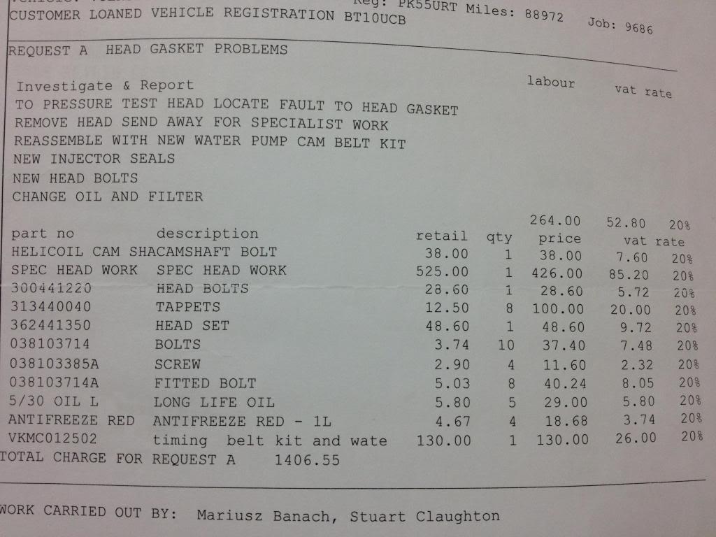

EDIT
Image below is when the works were done back in August 2011. If it is linked to that i am thinking now whether i can get them to fix it ???

I think my would be the lifters. As ive researched the noise im getting is very similar to them. Ive checked my alternator and that are it all seems fine the noise if coming from the top back of the engine after using a tube to listen to where the noise is coming fromZ
Well i got it booked in at 8am in the morning and if they confirm with me it is lifters i think i will need to flush the engine an renew the oil
