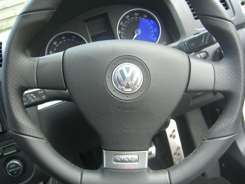

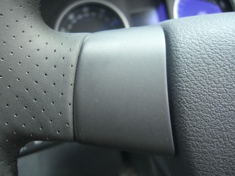

Ive got a steering wheel without MFSW buttons and the panel where the buttons would be has started peeling and looks  :sick:
can these panels snap off and be replaced?looks like they come off but dont want to pull too hard! if they do has anyone got a part number?

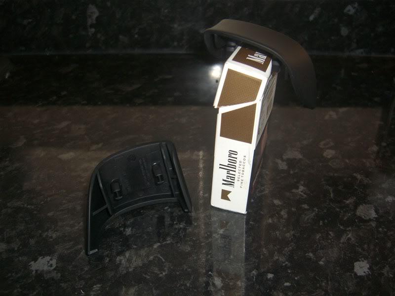

taken from my build thread:

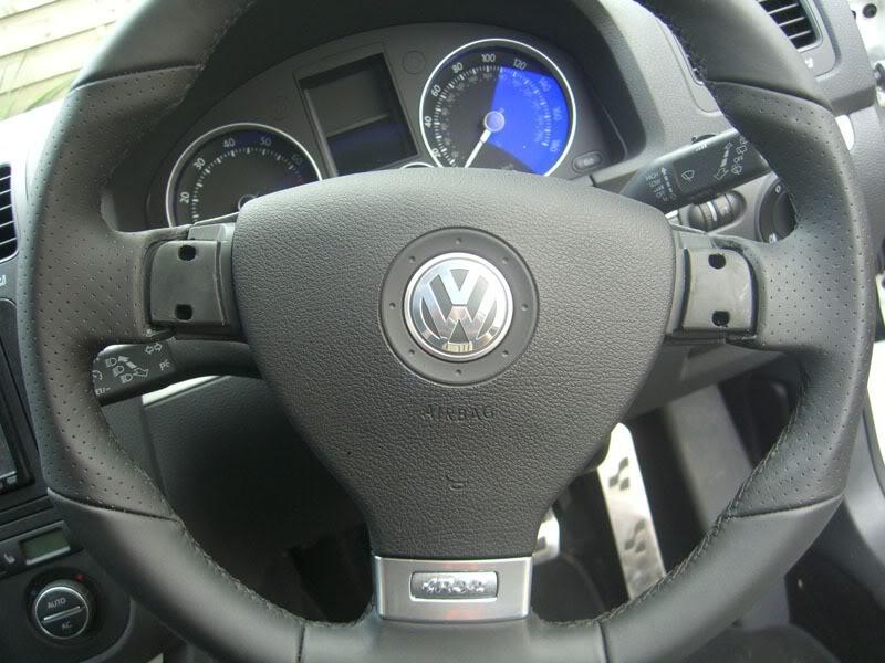

Right, another little sprinkling of candy into the car, should have done this when i did the rest of the trim, oh well  :laugh:
the before...whole lotta grey

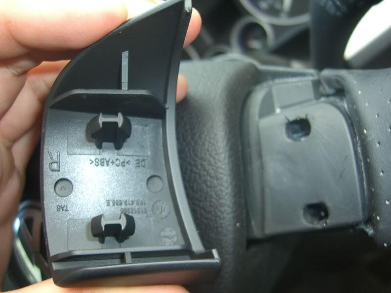

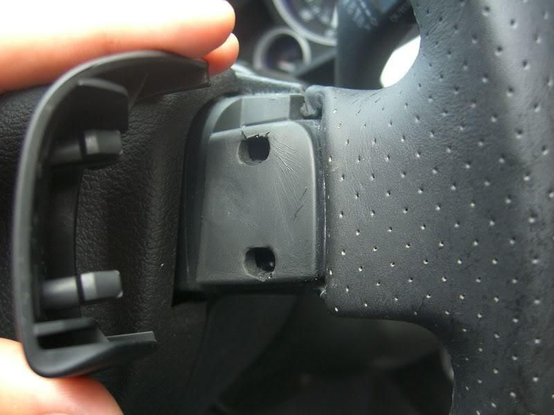

screams for something, to remove just grib underneath the top and bottom and wiggle it like the wind (cheers beezer  :grin:)
just 2 plugs holding it on
a better view
leaves me with this

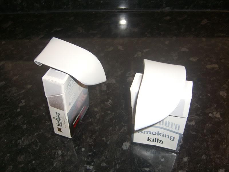

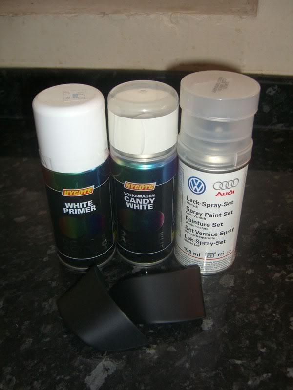

ready to be attacked with white plastic primer, candy paint and some lacquer, dont forget to sand between coats!
time for a top tip!  8)
get some cigarette packets and pinch them slightly on the top, the insert will now happily wedge onto them allowing you to spray all around it and stand it up while it dries, like so
mid spray

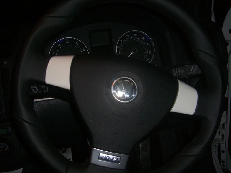

....aaaaaaaaaand we're done  :happy2:
Re: Steering Wheel Inserts
« Reply #2 on: October 08, 2009, 06:44:34 pm »
blending in the rest of the trim gives you this:

I need to point out that if you have a  DSG steering wheel with flappy paddles and no MFSW controls, then these are held on with torx screws located under the airbag.
