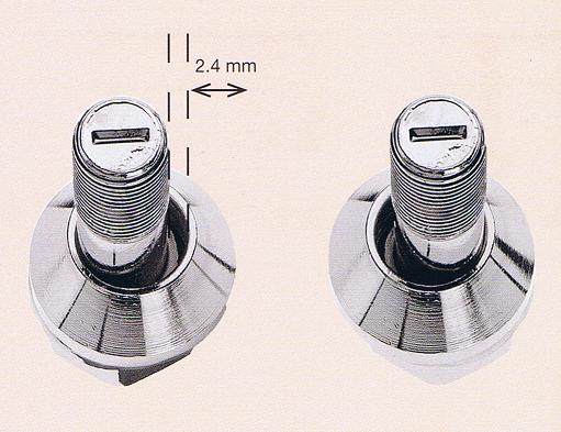

A bolt with a eccentric washer is not in itself dangerous, you'll find them use all over the place on cars, suspension usually to allow camber correction. Where people fall foul is not having the correct centrebore/spigot ring. The wheel itself must be centred tight to the hub, you can't run say a 60mm centrebored wheel on a 57.2 (iirc?) VAG, as if it moves, then there's a chance you'll slip the wobble bolts too and you're in a whole world of pain.

I just can't understand how they work it's like ur alloy holes are perfect with holes in hub but can't see how these bolts work as offset is few mm different lol
Might just be me but when inserting bolts it's like they fit perfect but wobble bolts move alloys few  mm is that what they do ?

The taper part of the nut is more like a washer, with a bigger hole which allows it to sit at a slightly different point than the centreline of the bolt - thus correcting the PCD.
