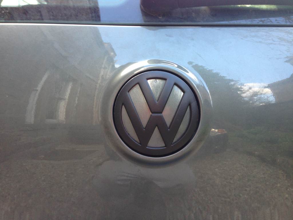

That's what I did, it does fit fine :) (I didn't do the best job of it but looks better than the whiteworm)

my old mk4 never had a badge like that?
the ones you can seperate and paint and fit for the mk4 comes off of vw sharans iirc

thats just the silver bit off a mk4 badge that I separated and plastidipped black
