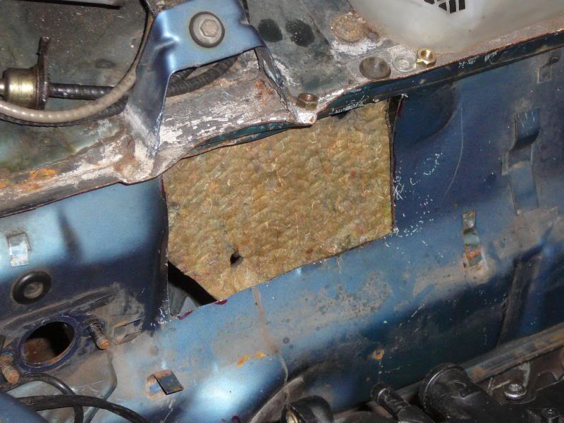

« Reply #15 on: June 05, 2013, 10:55:19 pm »

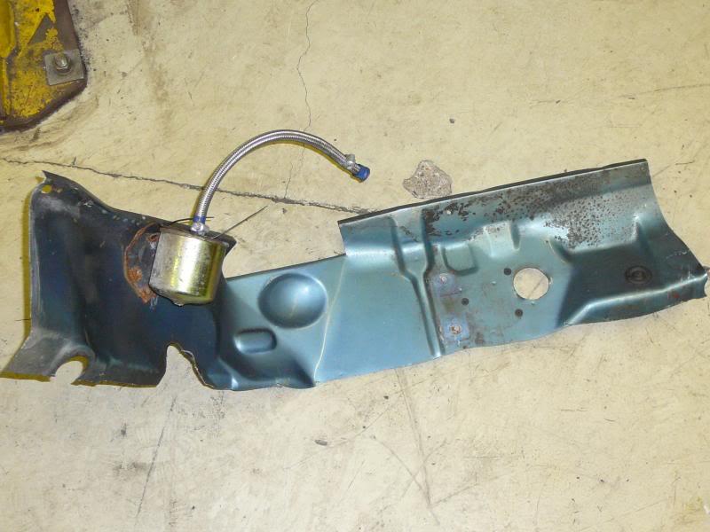

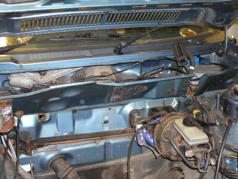

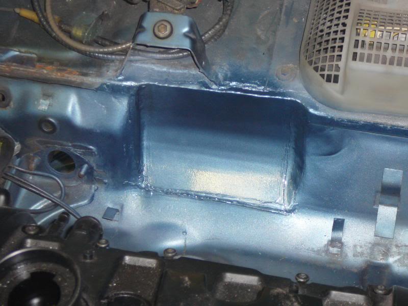

The Scuttle tray.
Removerd,

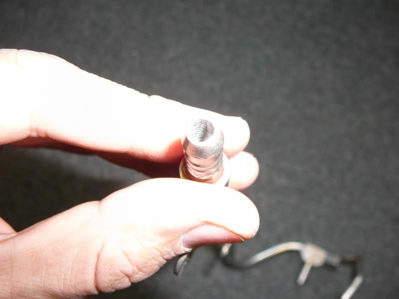

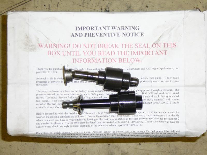

HPFP Autotech, Not ARP as I mistakenly stated earlier.
Home Made up-rated Engine fuel line.

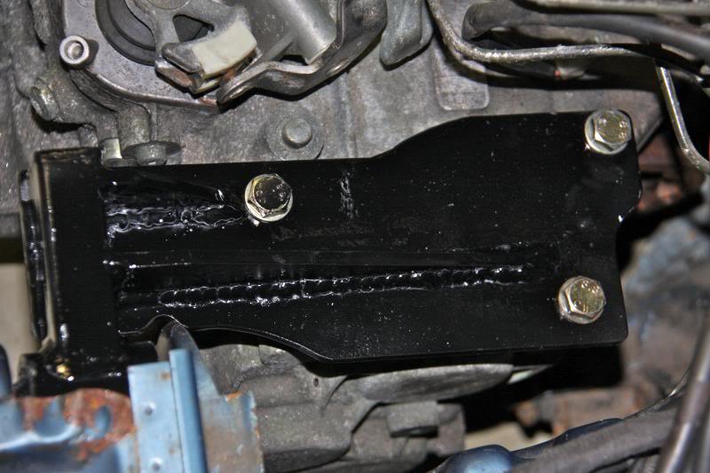

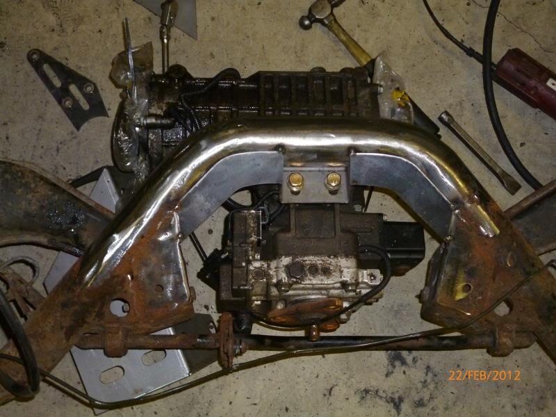

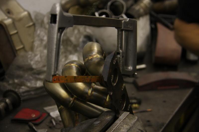

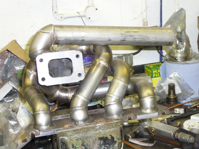

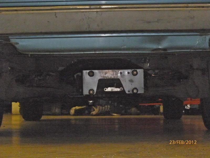

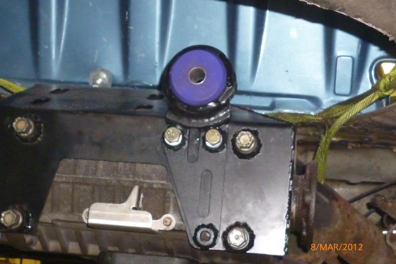

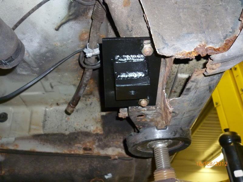

« Reply #16 on: June 05, 2013, 10:58:27 pm »

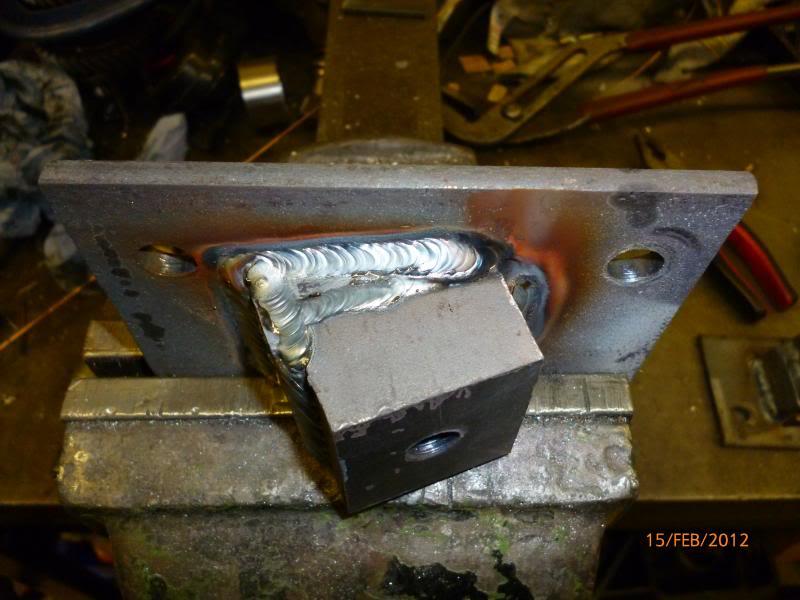

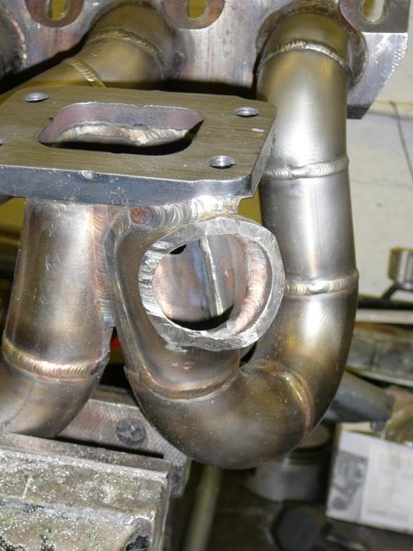

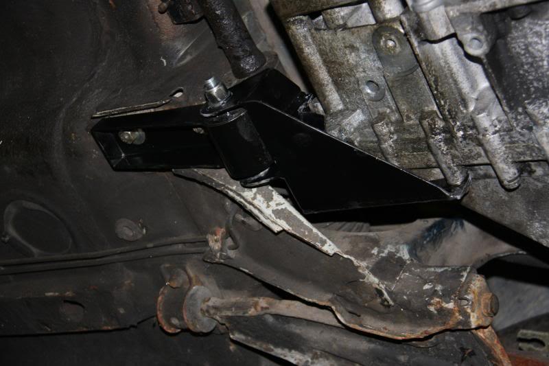

Fabricated gearbox mount.
Upper fabricated Gear box mount.

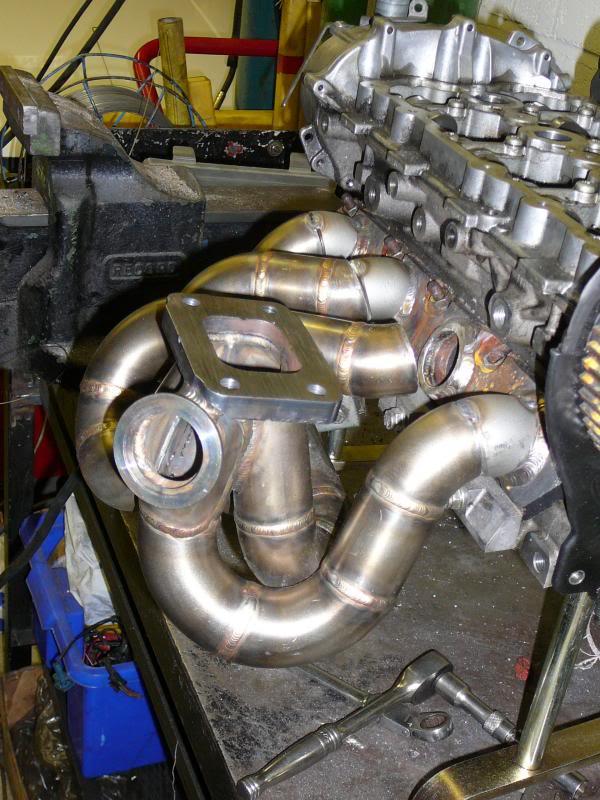

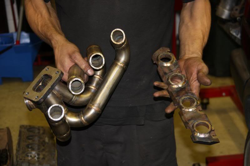

Yes that is a £1200 manifold with a hacksaw through it.
In Two! We must be mad.

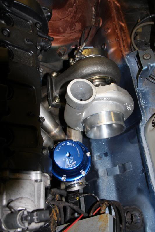

Offline fenix
  • Posts: 30
Re: Hi Guys Not A MK5 But the running gear is :-)

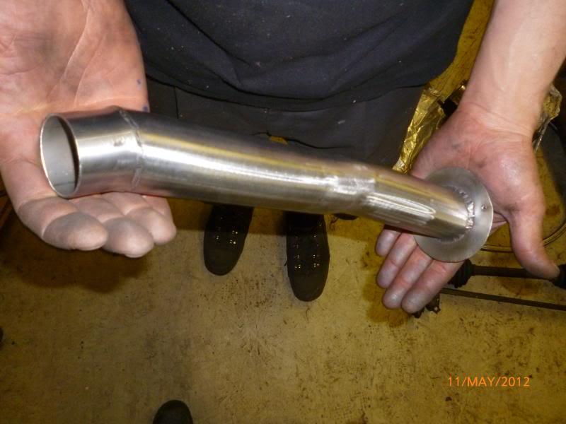

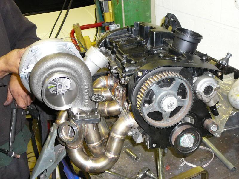

« Reply #17 on: June 05, 2013, 11:01:32 pm »

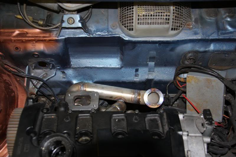

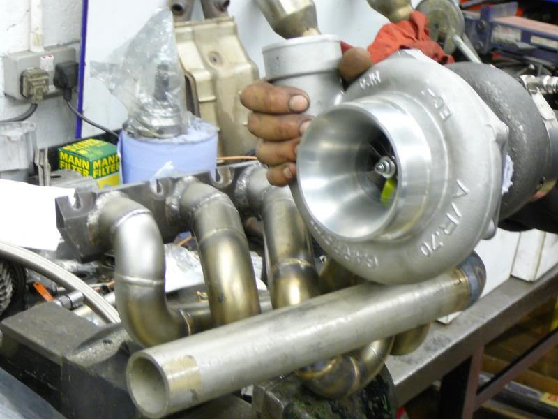

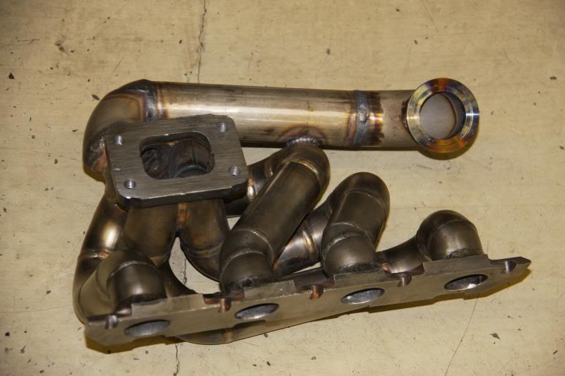

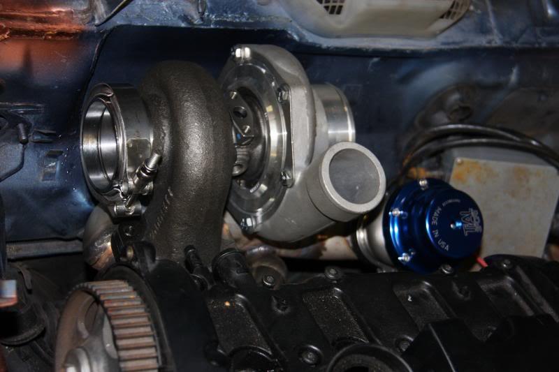

First cut in the chassis for the Prop.
Manifold flipped 180.
Mocked up with the turbo on.
Getting Idea for the down pipe.

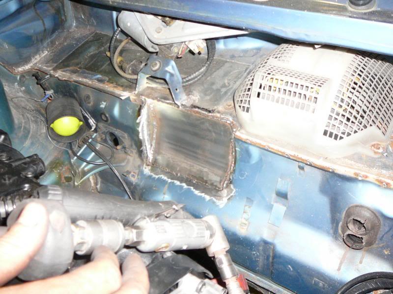

Offline fenix
  • Posts: 30

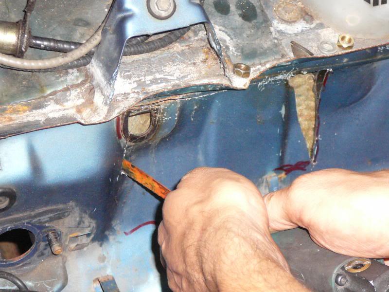

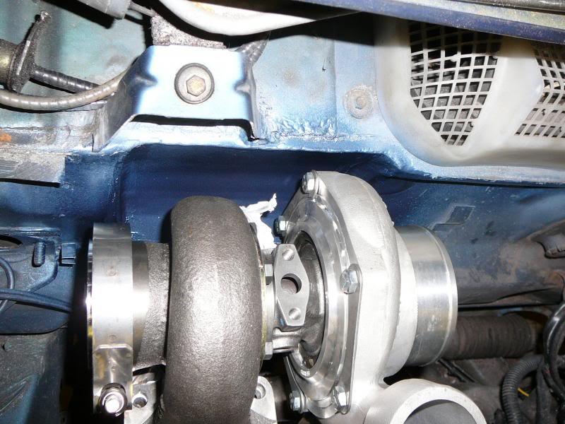

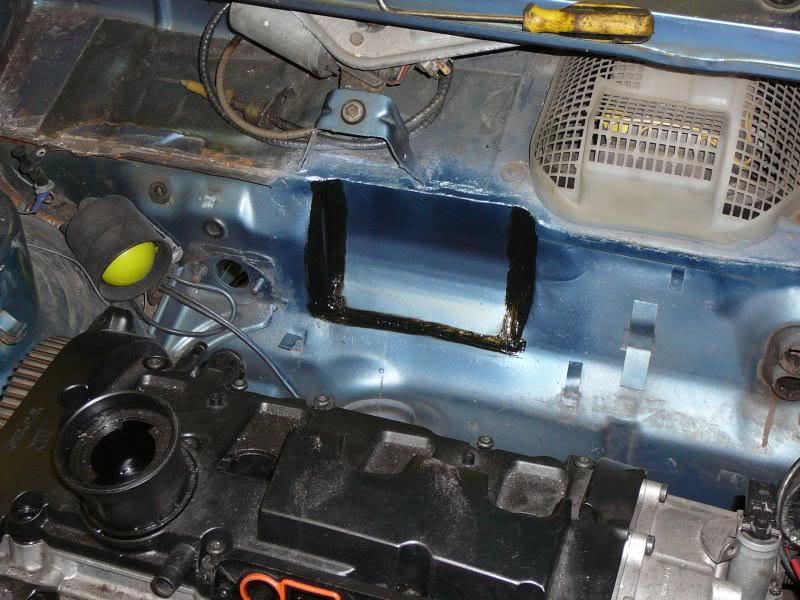

« Reply #18 on: June 05, 2013, 11:03:56 pm »
Cutting the recess to fit the turbo!
Piece removed
Recess fabricated.

Offline fenix
  • Posts: 30
« Reply #19 on: June 05, 2013, 11:05:55 pm »
Mocked up again.
Re routing the Wastegate for easy access when its all in. Incase we need to change springs and seals.
Offline fenix
  • Posts: 30
« Reply #20 on: June 05, 2013, 11:08:18 pm »
There it is Flipped 180 and wastage completely re routed.
Mounted in the car.

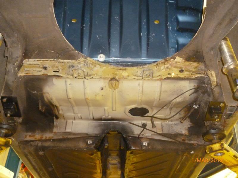

Offline fenix
  • Posts: 30

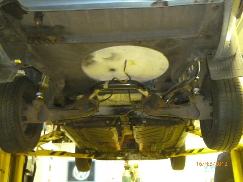

« Reply #21 on: June 05, 2013, 11:09:51 pm »

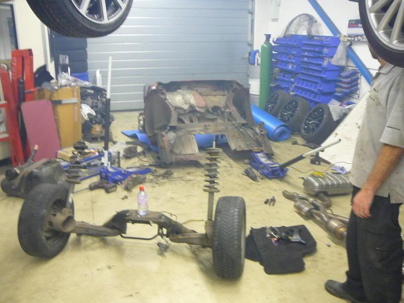

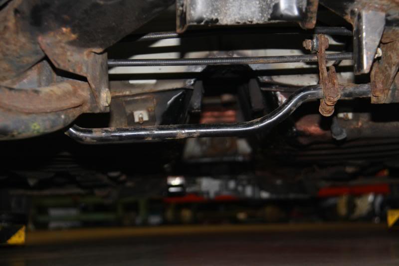

Rear beam removed from the syncro.
Offline fenix
  • Posts: 30

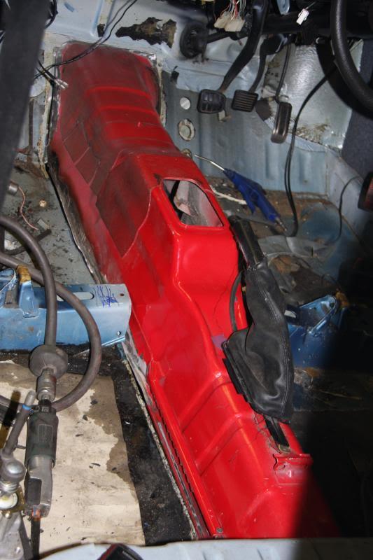

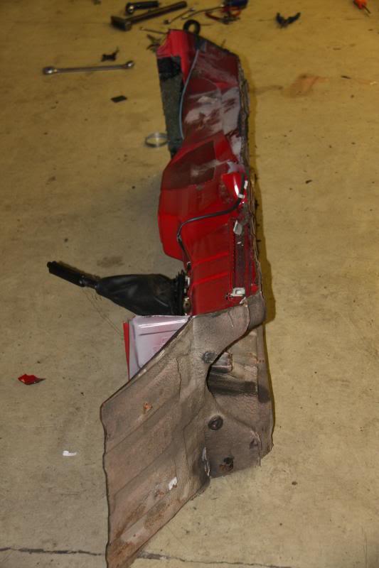

« Reply #22 on: June 05, 2013, 11:11:58 pm »

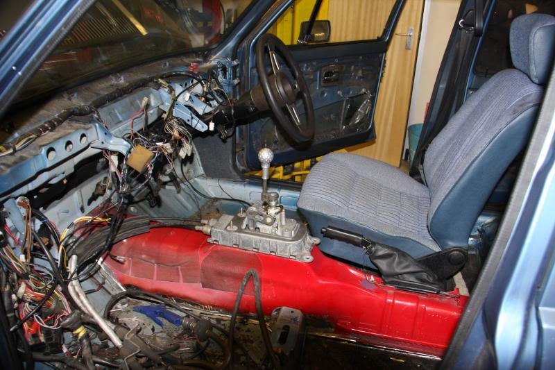

Donor Tunnel.
Floor removed
New tunnel tacked in.
Mocked up for gear lever position.

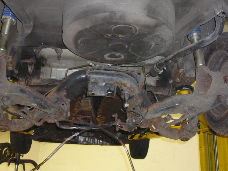

Offline fenix
  • Posts: 30

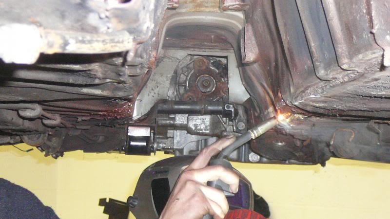

« Reply #23 on: June 05, 2013, 11:13:35 pm »
welding in the tunnel 360 in and out.
A look at how the new beam measures up.
Offline fenix
  • Posts: 30

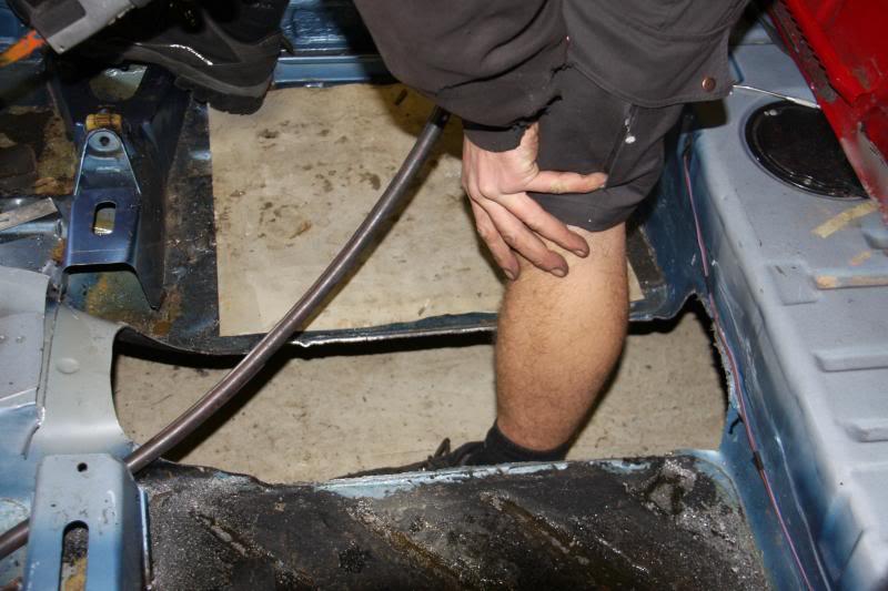

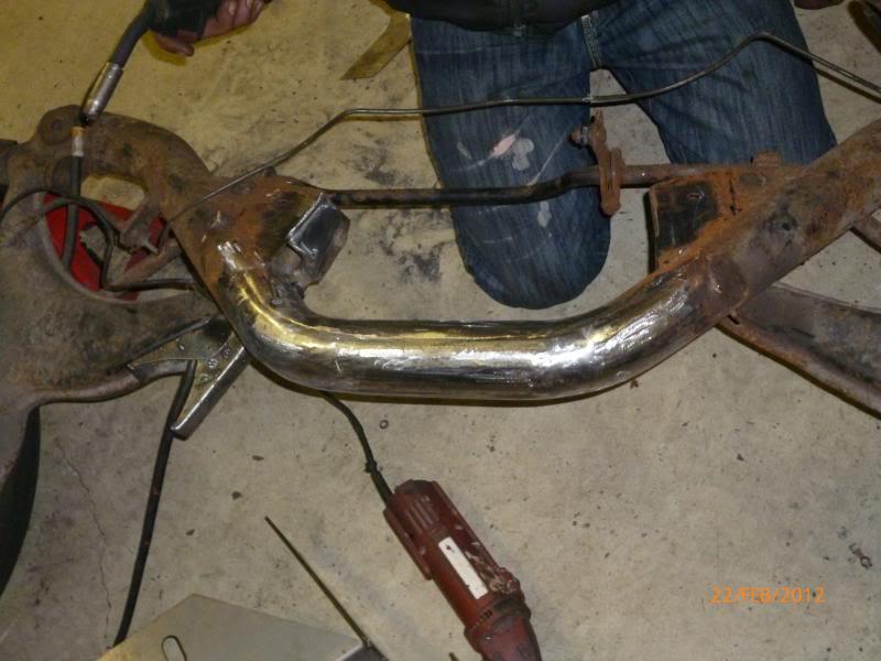

« Reply #24 on: June 05, 2013, 11:16:13 pm »

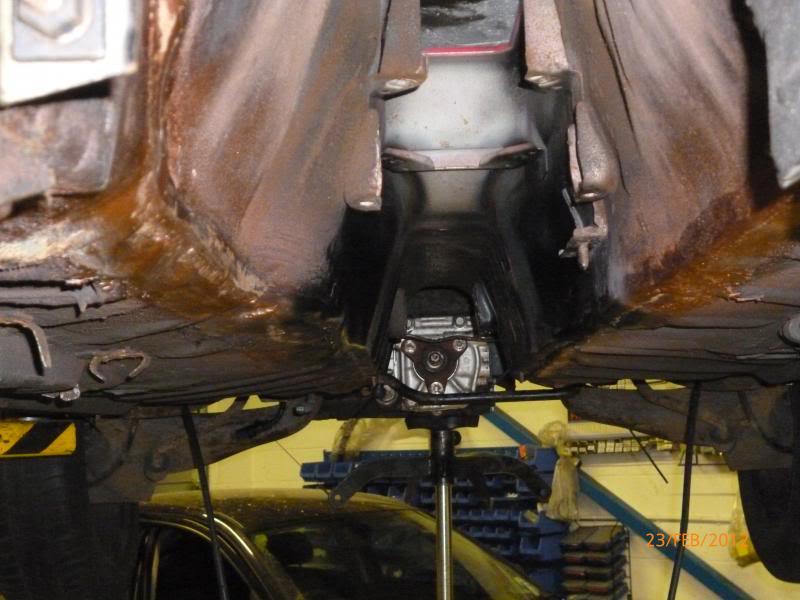

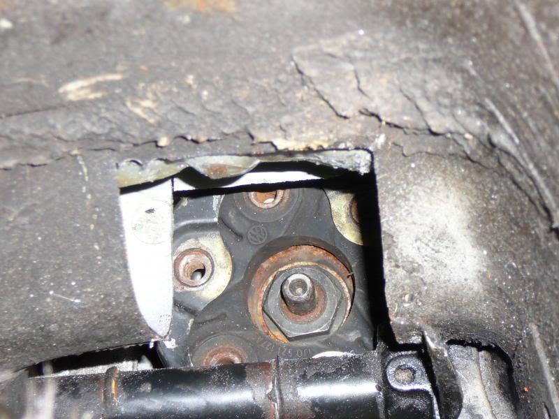

Wheel well had to go.
A view down the tunnel.

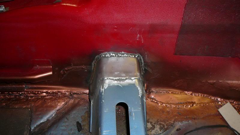

New axle mount.
In place,

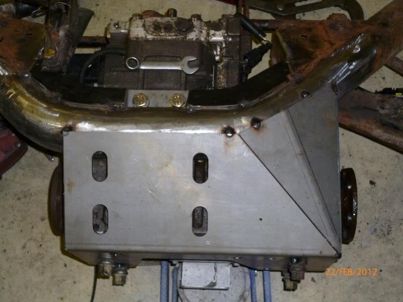

Offline fenix
  • Posts: 30
« Reply #25 on: June 05, 2013, 11:18:07 pm »

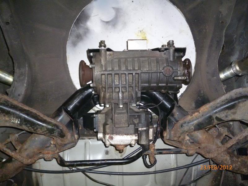

Rear beam bolted up.

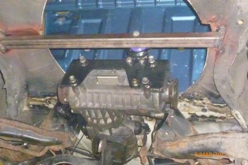

Syncro Diff removed ready for haldex unit.
Haldex offered up.
New cradle tacked on.

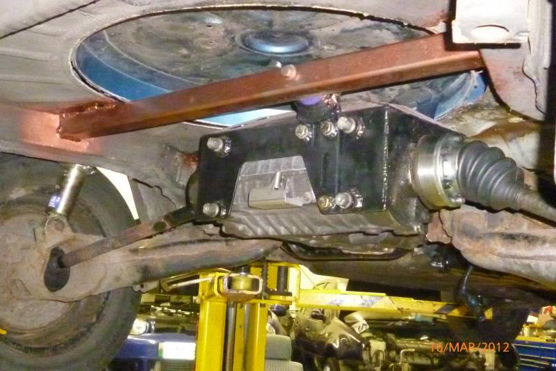

Offline fenix
  • Posts: 30
« Reply #26 on: June 05, 2013, 11:20:23 pm »
Better view down the tunnel.
Haldex in place.
Axle and diff all bolted up properly.

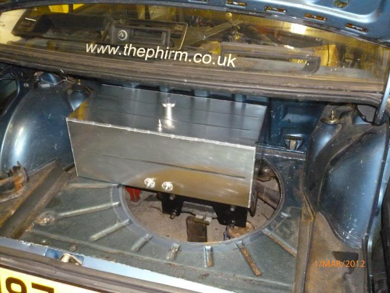

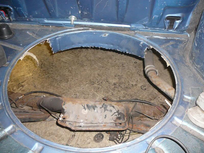

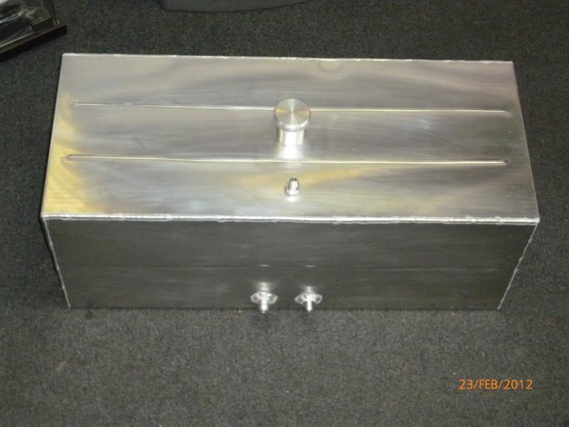

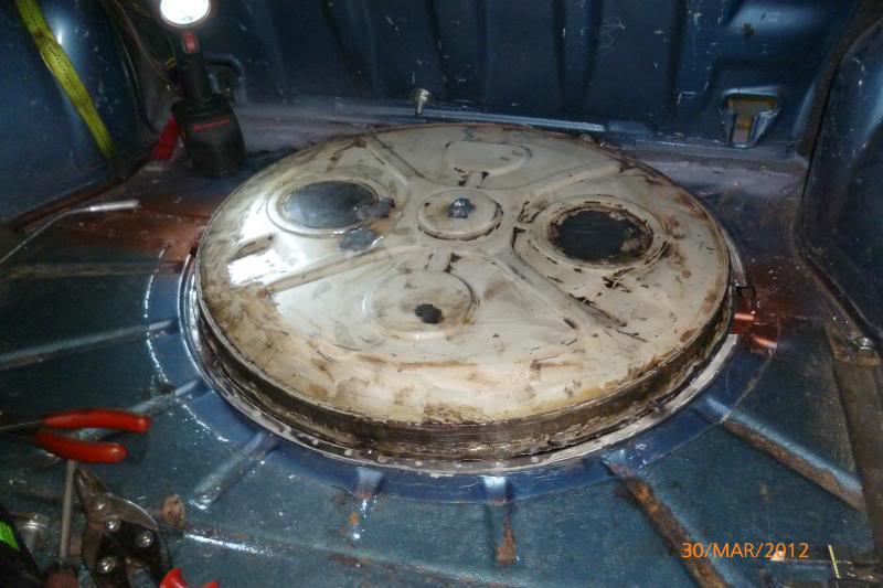

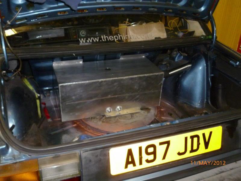

Fuel cell.
Offline fenix
  • Posts: 30
« Reply #27 on: June 05, 2013, 11:22:58 pm »
Bare view of the floor with axle mounts in place.

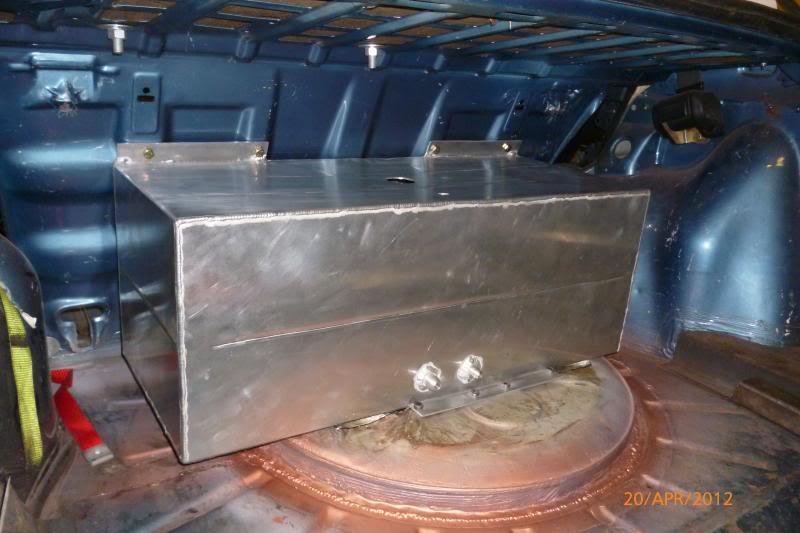

Tank mocked in.
Diff mount made.
Floor bar made and welded in.

« Reply #28 on: June 05, 2013, 11:25:15 pm »
Wheel well flipped and shortened.

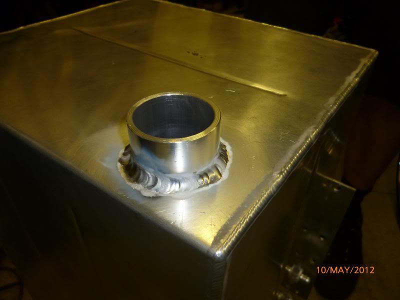

Tank bolted in.
Filler hole made in top of the tank.
Offline fenix
  • Posts: 30
« Reply #29 on: June 05, 2013, 11:29:07 pm »
Stainless filler to go from original filler hole on the mk1 to the cell. No fuss at the petro station for me.
