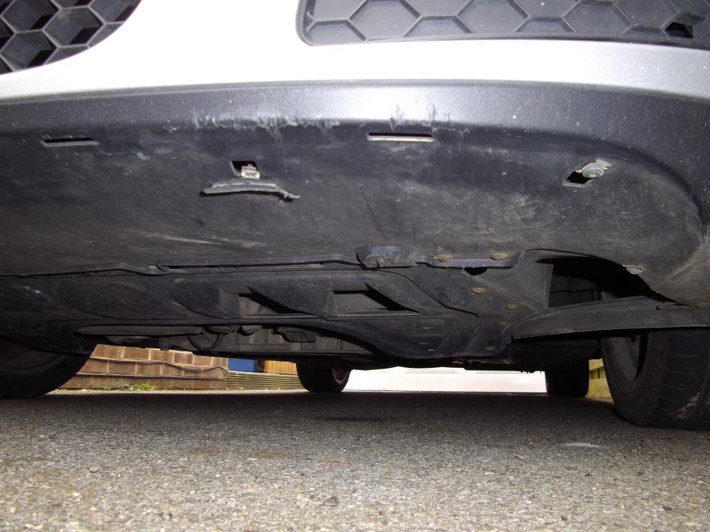

As above, I had the car jacked up this weekend and noticed under the front of the bumper about 5 torx bolts with little bits of plastic lugs left on them and what ever they held gone!?  Does the GTi come with an additional front splitter from new?  If so, I think mine has gone and I'll have to replace it!!

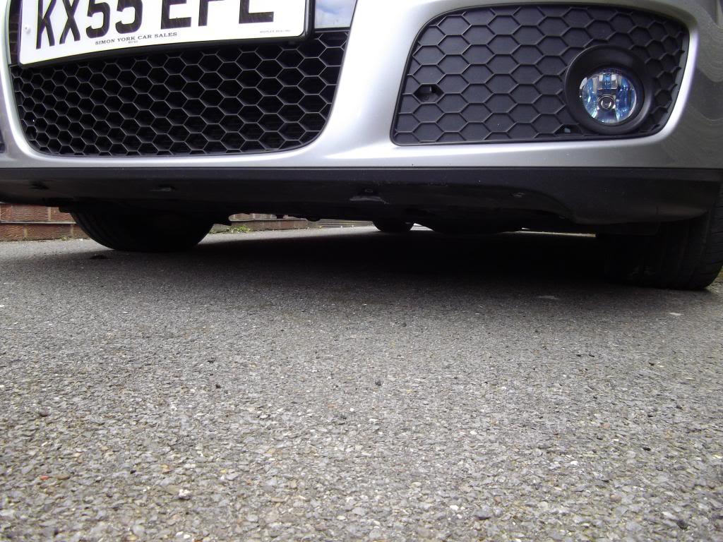

Hi guys.
Interesting, looks like part of my front trim is missing!
I have the "side" parts of the front which runs under the fogs, then as this thins out, it looks like there is a small thin "lip" spoiler which screws onto the bumper.  It's this which is missing on my car!   :confused:

« Reply #5 on: April 02, 2013, 04:33:59 pm »
ok, here goes!
Let's see if that works!?
Yes it does! :jumpmove: :pomppomp:

« Reply #6 on: April 02, 2013, 04:41:39 pm »
oooooohhhh!
Compairing the pics to Kalpsn2000 I now feel naked!!!! :ashamed:
Need to buy a new part ASAP!
I don't think I want to know how the old one was torn off....... :confused:
Re: GTi Front Bumper comes with OEM splitter or not?
« Reply #7 on: April 02, 2013, 04:42:05 pm »
You are missing this bit, below.
GTI spoiler turned upside down so you can see the splitter (in black)...
Part number is 1K0 807 110 9B9 from your local dealer.
