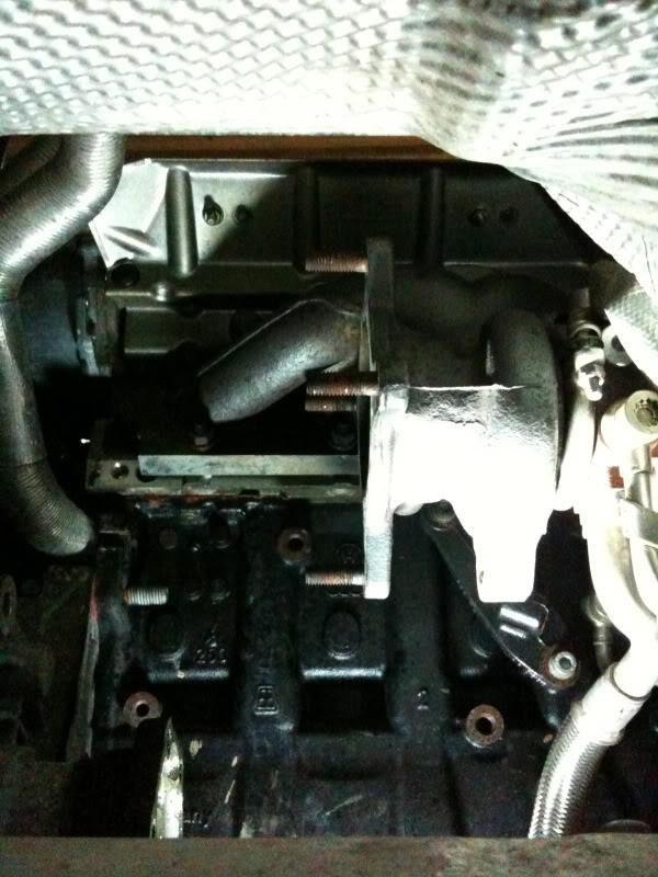

Bit of an update after some work today..
First of all, a couple more pictures of the turbo for a bit of scale..
So first job was to strip down the car ready to remove the standard turbo, so downpipe off.. Im going to adjust my custom 3" downpipe which I had made to work with the K04 turbo, so with use of a 3" v-band flange ill make it work with the new turbo..
Without the downpipe.. (ill use this picture as a before and after once its finished)
Drive shaft lower boost pipe and driver side wheel arch liners etc removed to make room..
Intake off, drain the oil and water out, then pull off the stock K04 turbo and manifold..
Bit of a mess..
Also a comparison shot of the K04 sat next to the BSH manifold and Owen Developments GT3076R
So with that done we hung the BSH manifold on the head, checked for fitment of the lower boost pipe, how much work would need to be done on the downpipe and clocked the turbo for the lower boost pipe fitment..
Not bad for 3 1/2 hours work!!
Tomorrow, injectors, bolt up the manifold and turbo to stay along with oil and water lines, make a start on the lower boost pipe and downpipe adjustments..
Going well so far!
