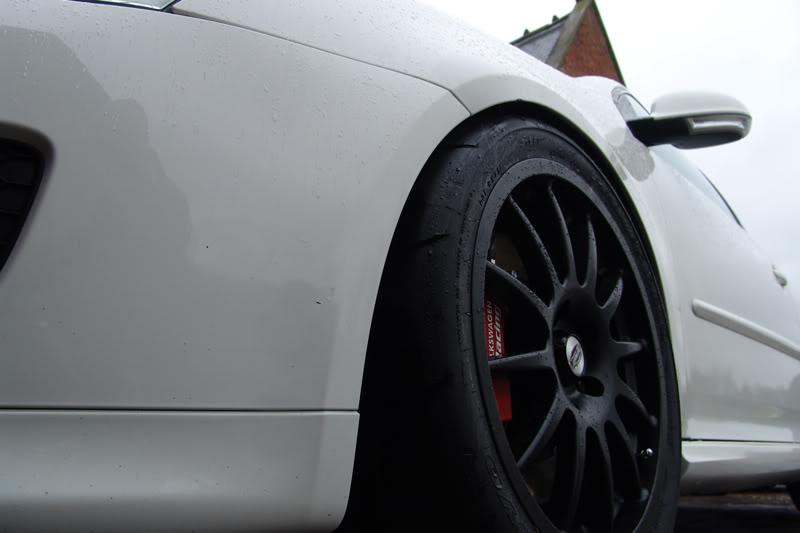

New wheels arrived and looked like they may turn out to be an absolute nightmare to fit.. They do look awesome however, the new Pro Race 1.3 is quite a different design to the 1.2.. Only really noticeable when the two are side by side..
The wheels were made to order and the specs are as follows..
Team Dynamics Pro Race 1.3 in Satin Black - 18 x 8.5 / 5 X 112 / ET50 / 57.1
Tyres are super fat.. Toyo R888 - 255 / 35 / 18
I test fitted the wheels this morning and everything looked ok really, the clearance from the strut to the tyre on the front is around 2mm and at the rear about 4mm.. Clearance from the tyre to the arch at the front is about 3mm and the rear about 3mm again.. So to say that they JUST fit is an understatement!!

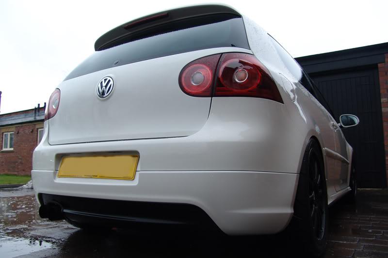

Anyways this is how they look on the car..
Before the first drive I lightly painted the inner side walls of the tyres with white paint to help look for any signs of rubbing on the strut front and rear, came back and everything was ok.. Its VERY close, but importantly no rubbing what so ever..
Just to give an idea on grip levels.. I can now PLANT the throttle in 3rd gear in the wet where as before with the 225 / 40 T1-R's I couldn't even do that in the dry.. Traction is pretty incredible..
Bare in mind this is with stock top mounts at the front, but lots of work on the arches all round, so clearance will only improve once I dial in a little more camber on the front end.. Carefully specced offset / width and arch work and its possible.. I really think that an 18x9 with a 265 would work, but it would require the camber on the front end for sure, and more arch rolling / pulling..

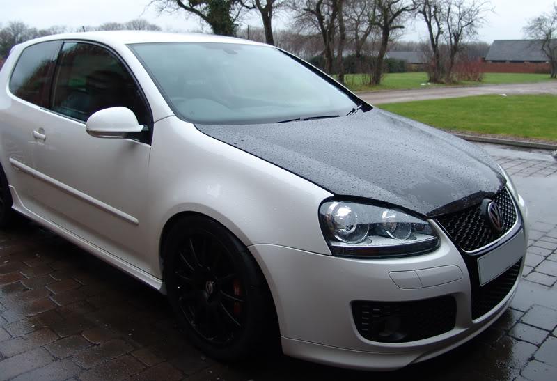

First of all the carbon bonnet was fitted.. Saving 14kg over the standard item..

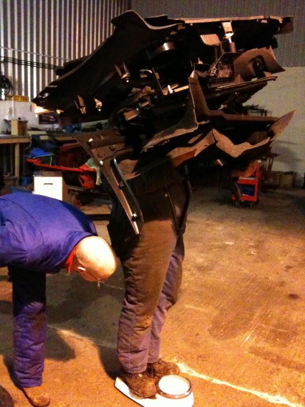

A total of 35kg came out the car (using a cunning method of weighing it all)

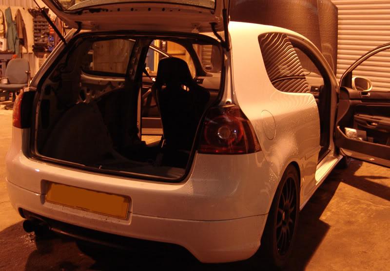

Which leaves the cars interior looking like this at the moment..
Based on the last time the car was on scales and how much more I have taken out since the weight should be at 1175kg with a total of 226kg already out the car!!! I have calculated that there is another 140+kg to come off the total weight of the car, which would bring me very close to my 1000kg target
