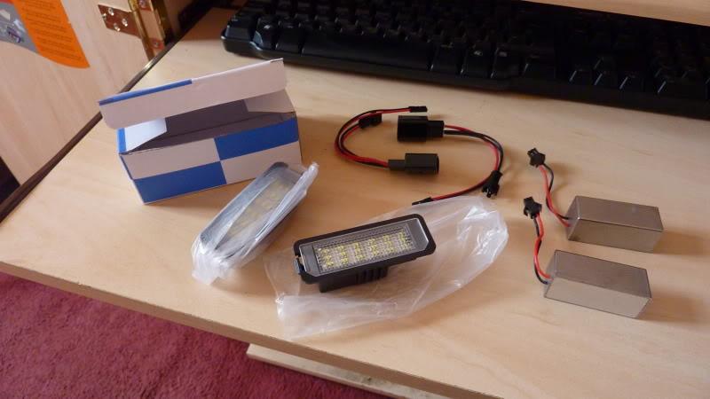

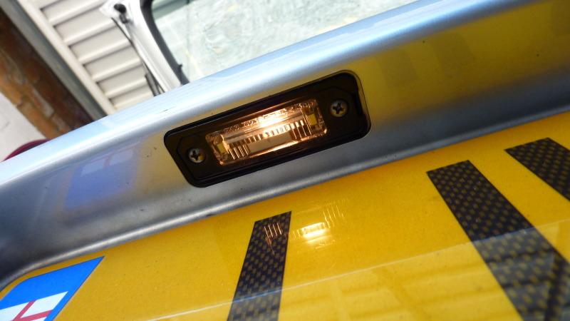

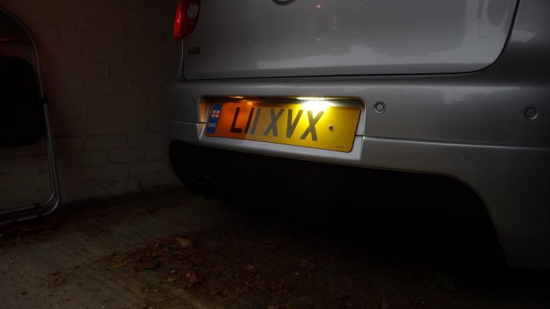

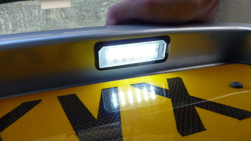

i fitted the 18 led units to my car, They are very bright,
I took these pics when it was still dusk so not getting the full effect from the pics, But gives you the idea.
one side done and one side standard.
I have these no issues at all !
Previously had ones from the rocco these gave errors and often needed to restart the engine or turn lights off and on again to get them restarting.

From your pics, Cap, I gather they're just push-fit?
That's right,
Just unscrew the old ones and disconnect the cable, reattach the cable to the new unit and pop back in.
The little silver boxes that you see in the pic are the resistors, I didn't use them and have no problems whatsoever
