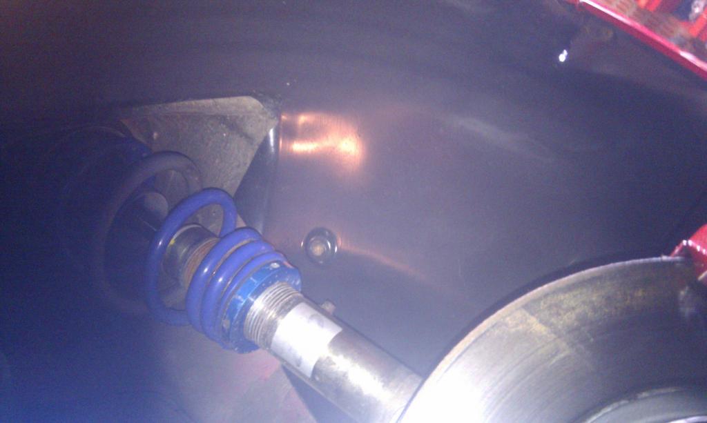

Yeap easy mate, just grab a little pot to keep all the screws in, about 15-20 in total per side.

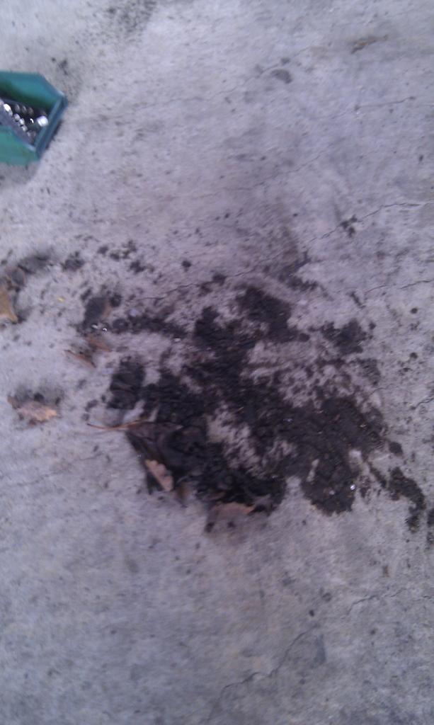

I did my drivers side at the weekend as I was fitting my new DV. The crud that came out was a lot, esp as not the nearside (picks more muck up from curb side). Will be doing the other side asap.
All this muck was behind the arch liner, cleaned it all up nicely!

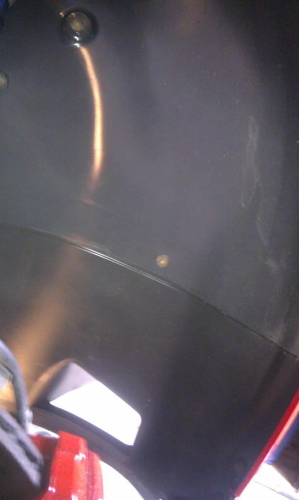

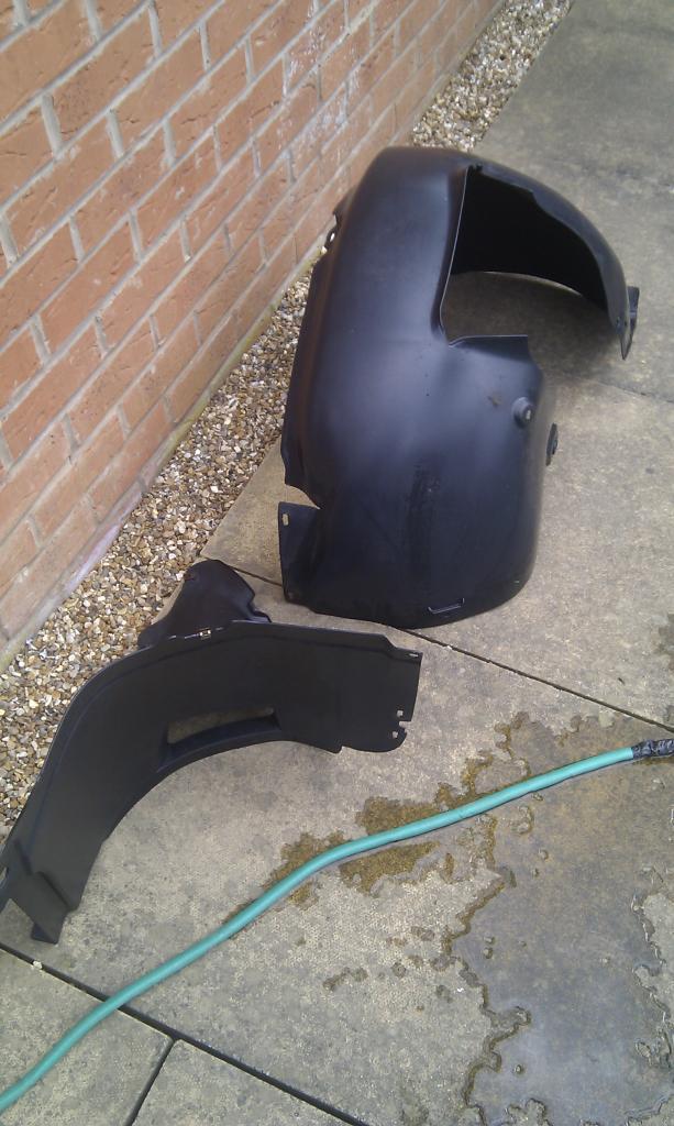

Cleaned the arch liner (both parts) as it was out:
Can clearly see the difference, shame its underneath, ha ha. Will get round to doing the others soon:
All the muck I got out:
