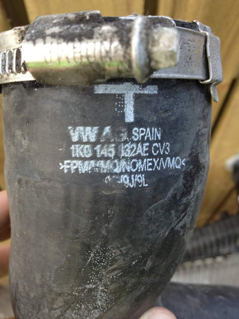

Whats the part number on that intercooler...?
The pipes that are a straight fit should be 1K0 145 832 L/S and 1K0 145 834 AA. Mounting points should be identical, these will be on the aircon radiator and the rad/fans.
I found a thread which said the following bolts were required, m6x1.0 x 16mm long (9 of these) and m10x1.5 x 100mm long (2 of these). It did mention that the standard bolts could be used but just be careful putting them in due to the plastic mounting points.

The intercooler PN is: 1K0 145 803 AK
As you mentioned above, the pipes are numbered: 1K0 145 834 and 1K0 145 832. At least I know the pipes fit now and the mounts are the same! :)
