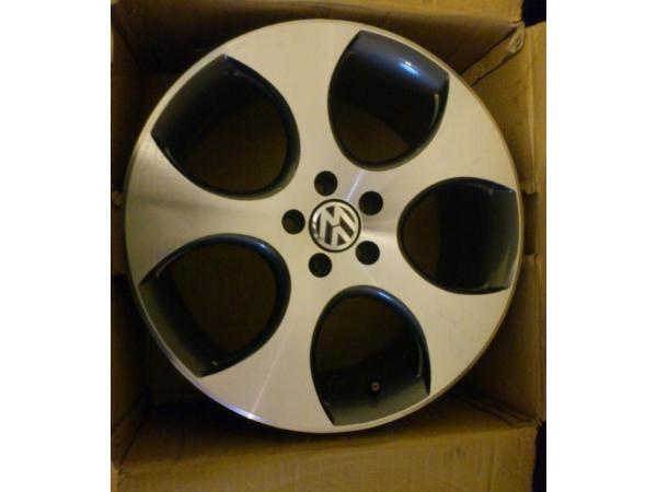

Cheers for the replies gents - its very much appreciated. Here is a picture of the exact alloy wheel in question.

Looks gen., but as stated the stamps inside are your proof.

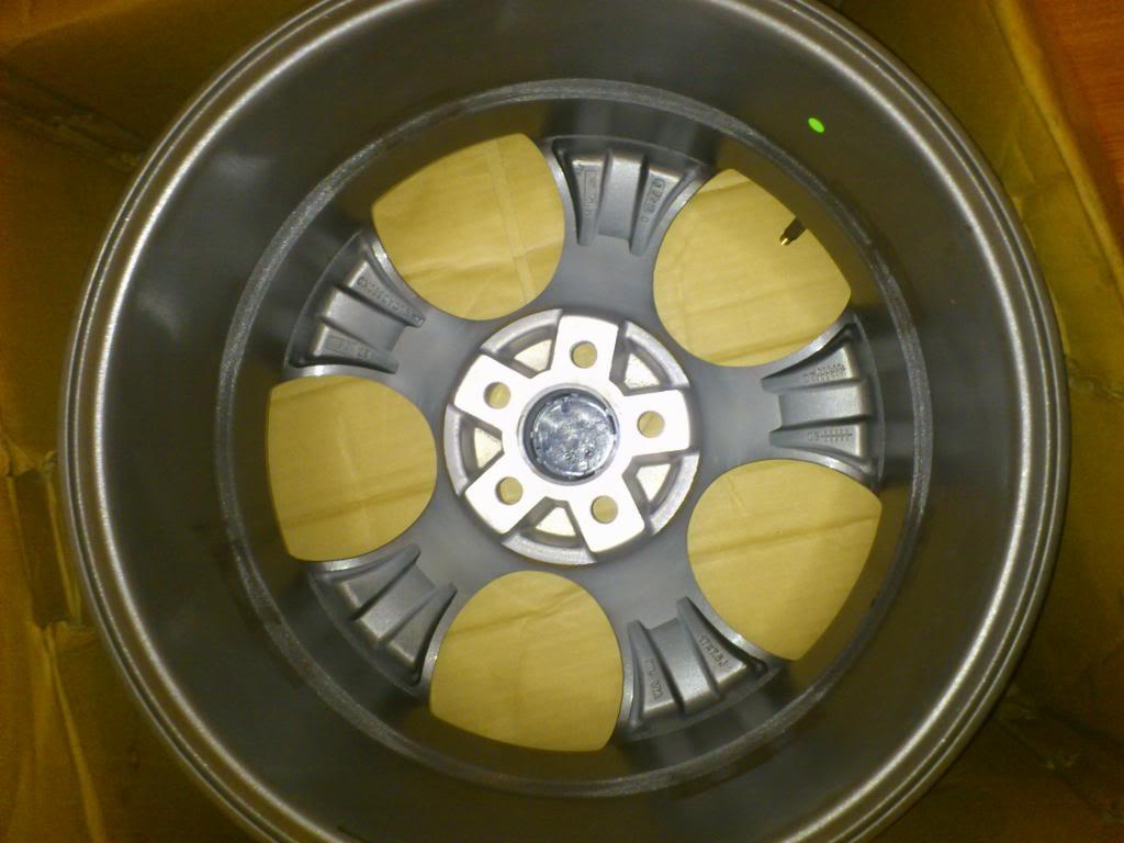

The owner is going to send me a picture of the back of the alloy so i can read what it says. Once this is recieved i shall post it up. Will be up in about 15 mins

Pictures sent by seller:

Hello mate, I think that wheel is a 17" according to the markings on the back of the wheel. I clicked on your picture and then enlarged it and the marking states 17 x 17.5J. I could be wrong but that aint an 18" wheel i'm sure.
Hope it helps

^ Was just going to say the same thing, 17 x 7.5J on the back. Seems to have a few stamps, but nothing that says BBS / Ronal at that resolution - which is kinda unimportant if it's a 17 anyway, lol.

I call fake!

17? could that not mean it's a Polo GTI wheel? because to my eyes the wheel looks genuine tbh
i still wouldn't buy it for your Mk5 however as the stud pattern is wrong (5x100 for the Polo, 5x112 for the Mk5)
