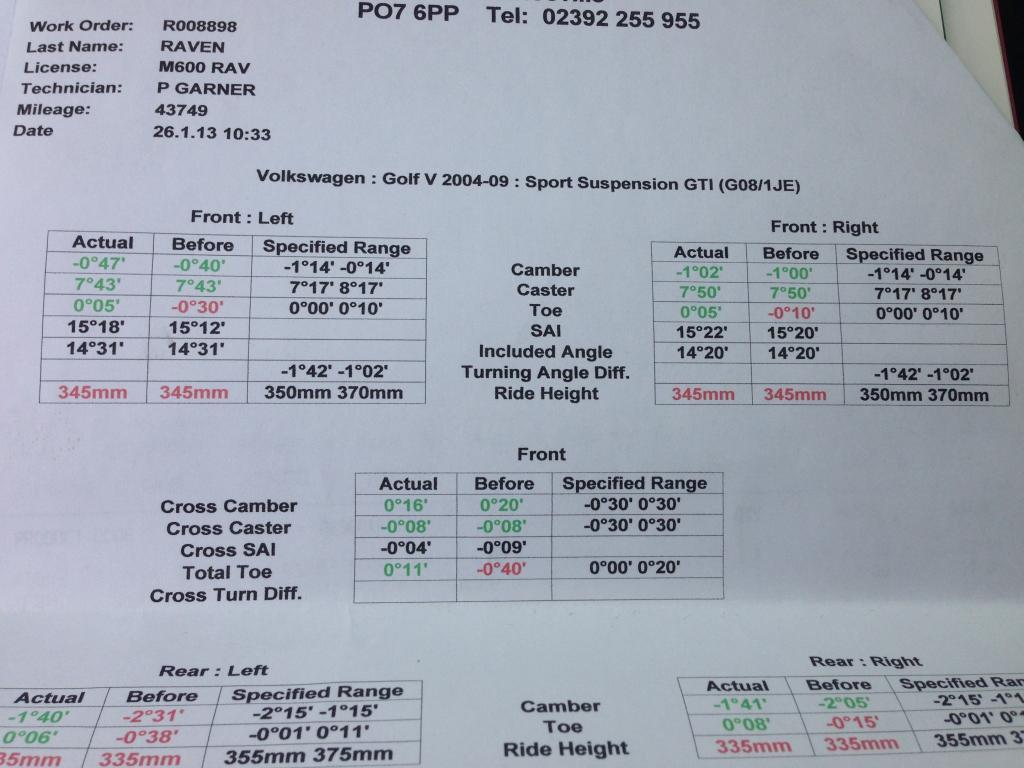

I had my car geometry sorted and having looked at it.. It doesn't look symmetrical both sides, is that right?
I saw on another threat that someone had neg 2 degree camber on the front to improve grip. Would it make a huge difference over what I already have?
I am thinking about getting a rear ARB to tighten up my handing, my car just doesn't feel direct enough.
Thanks in advance for any feed back
Mat

Its all spot on.  You cant get any more front camber on a stock MK5.  You would need adjustable ball joints or top mounts.

Thanks Alex, greatly appreciated.
How much different would putting a decent ARB onto this setup make? ( Eibach springs and ALK )
