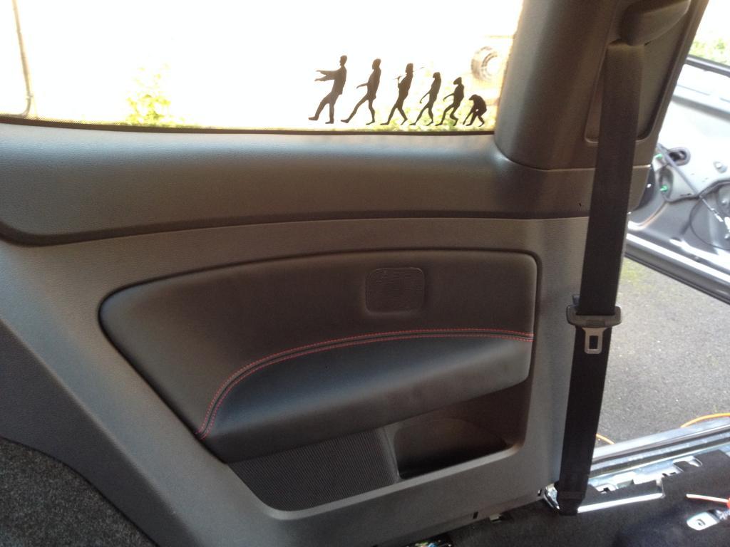

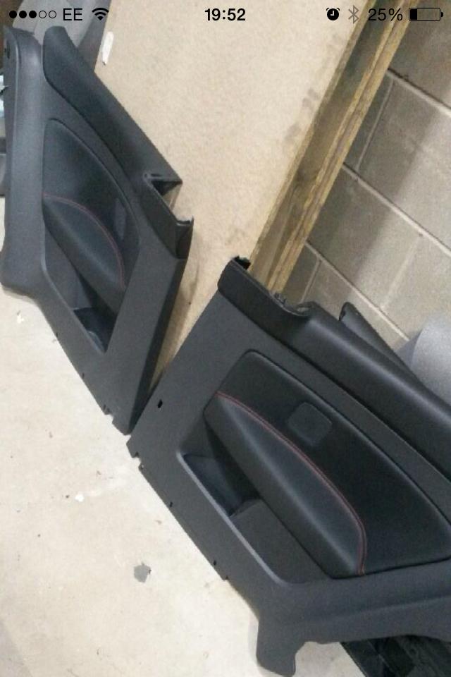

Another update from Del - Rear doorcards now in Nappa leather with red stitching

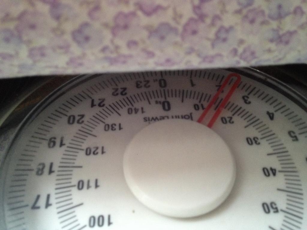

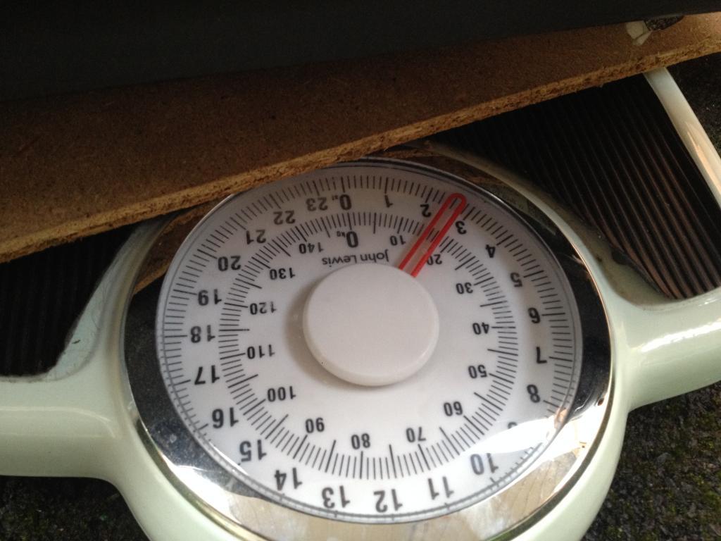

@GS WAX as promised weight comparison.....
Standard Ed30 Front seat - Approx 17KG
Recaro Front seat - Approx 14.5KG

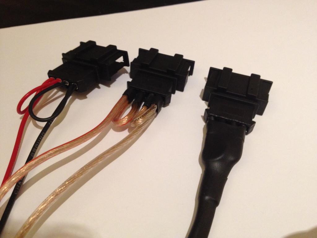

Started to fit everything today and have got these to upgrade to a ten speaker system
Didn't like the adaptors that I got so adapted the adaptors with better cable, left is how it came middle is modded and right is heatshrunk for strength

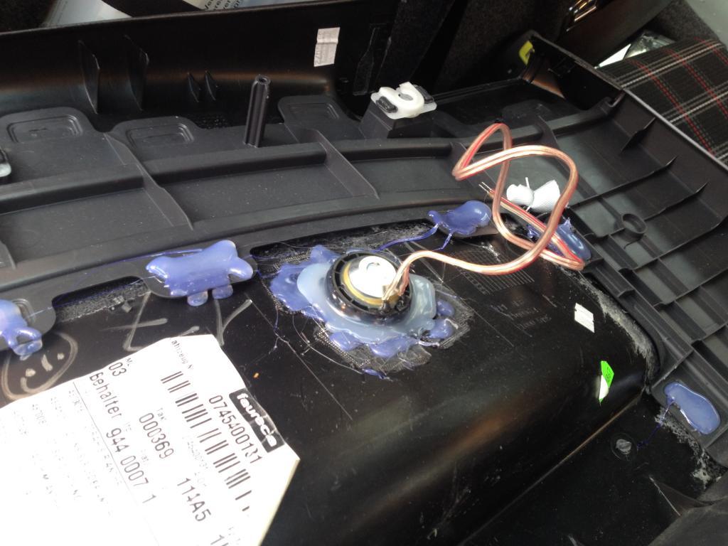

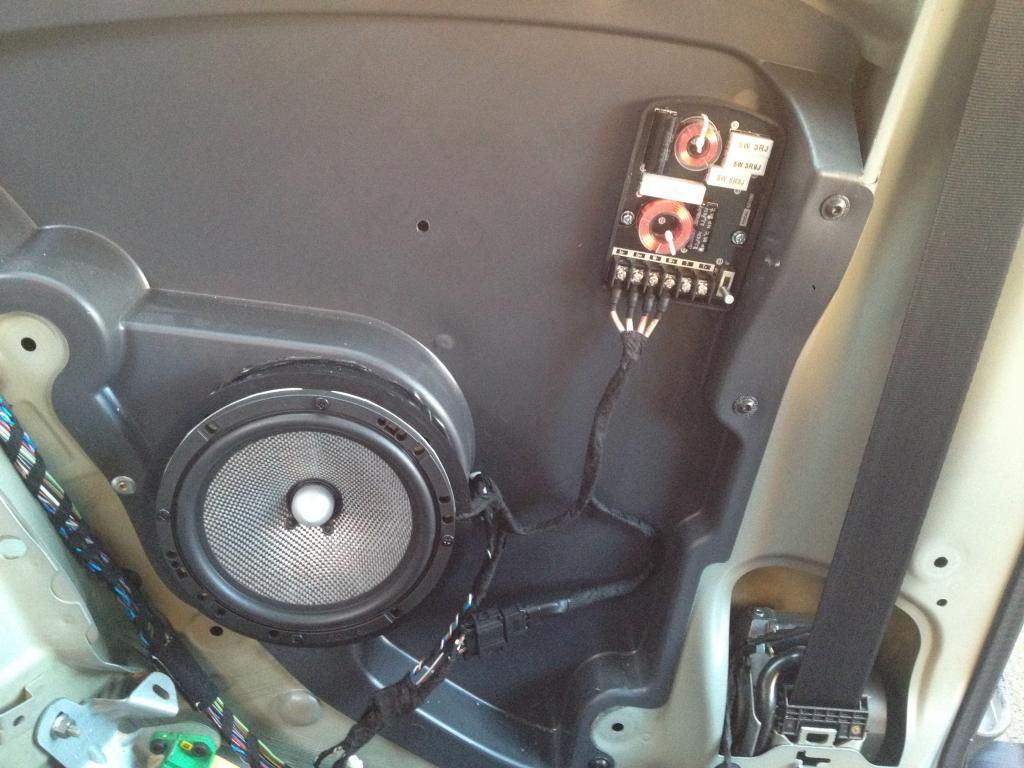

Crossover and mid/bass fitted, not going to have a big install so didn't sound deaden anything
Hot glue has been my friend  :grin:
Rears fitted, Bentley Nappa leather and red stitching
Not sure where time when today as that's all I managed, still got the front speakers to install and then the seats can go in  :party:

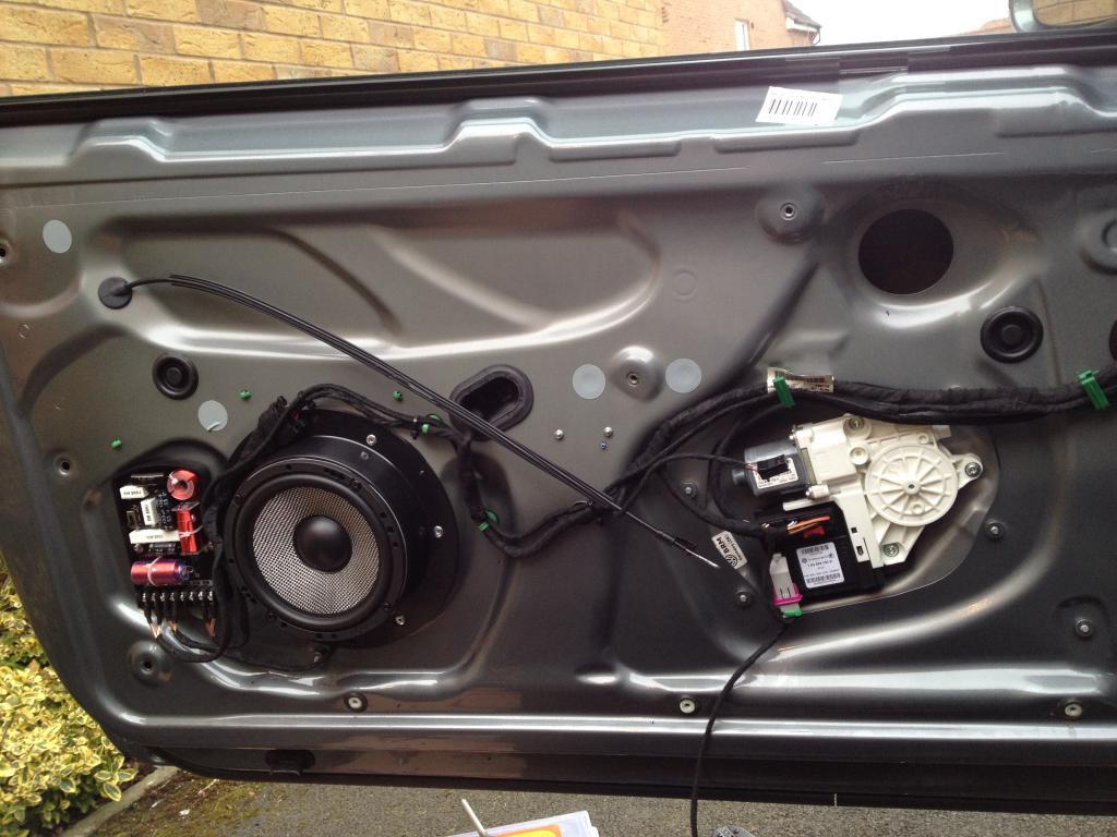

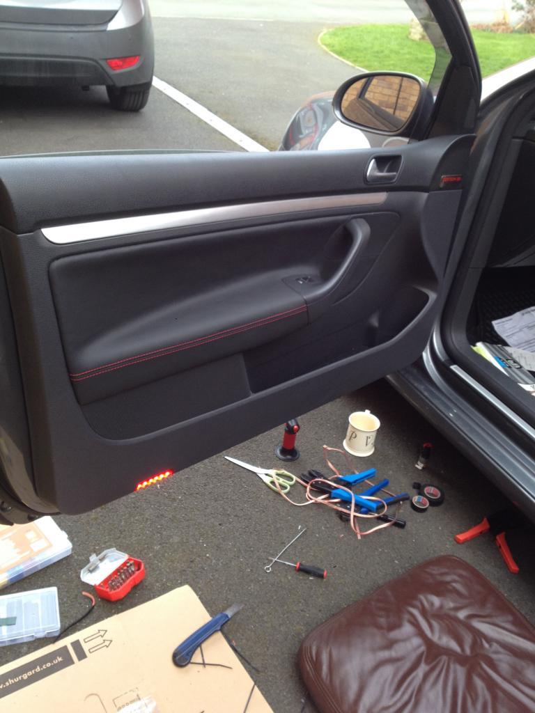

Front door speaker upgrade all installed - I now have a ten speaker set up  :happy2:
Passenger door done
Drivers door done

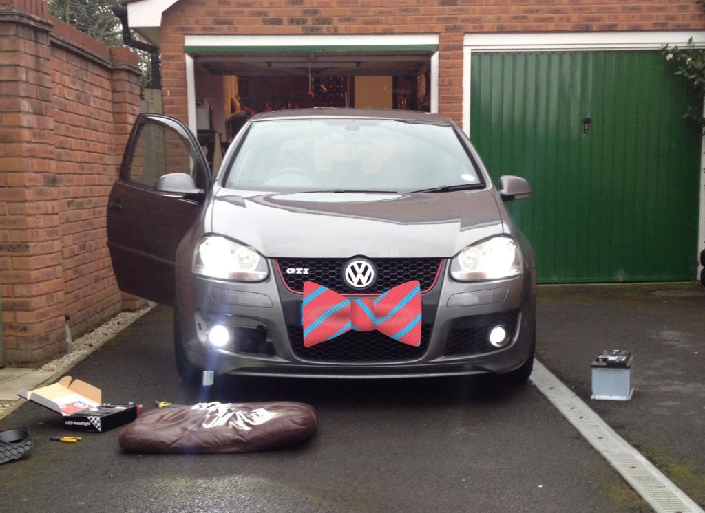

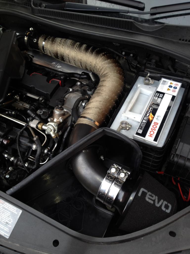

My battery is as old as the car and have wanted to update the battery for a while.  After advice from the battery thread on the forum I decided to go for a Bosch S5 007.  Not sure how I managed it but two were delivered to me so I have one for sale if anyone wants it? I also got round to getting a proper length of heat wrap as the stuff I had on before was left over from a previous project and wasn't long enough
I replaced my fog lights with projector type a while ago and put LED bulbs in but have never been happy with the light output.  After reading @v4rley review of the new Gen 3 Cree set up I couldn't resist any longer and ordered a set.  the origonals are on the left and the Gen3 Cree are on the right - bit of a difference!!
Old on right of pic and new on left of pic - not tried a night drive but even in the daylight the difference is outstanding.  I have corner lights turned on which is why I want better light out put - I don't drive with my fogs on all the time  :signLOL:
