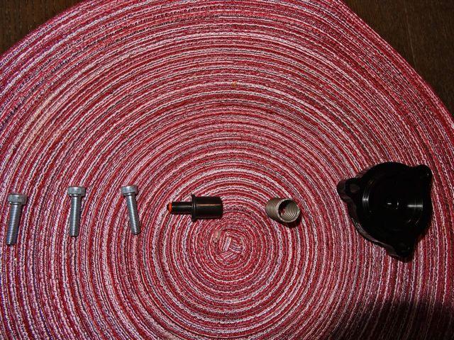

Guys got a set recently and wonder if I am missing a part?
I don't have the orange cylinder first on the left in the below pic
This is what I have
Paul

« Reply #112 on: November 15, 2013, 10:54:34 am »
You will struggle without that Paul

« Reply #113 on: November 15, 2013, 12:59:57 pm »
Your missing the main plunger part.

« Reply #114 on: November 15, 2013, 02:20:24 pm »
cheers guys!
