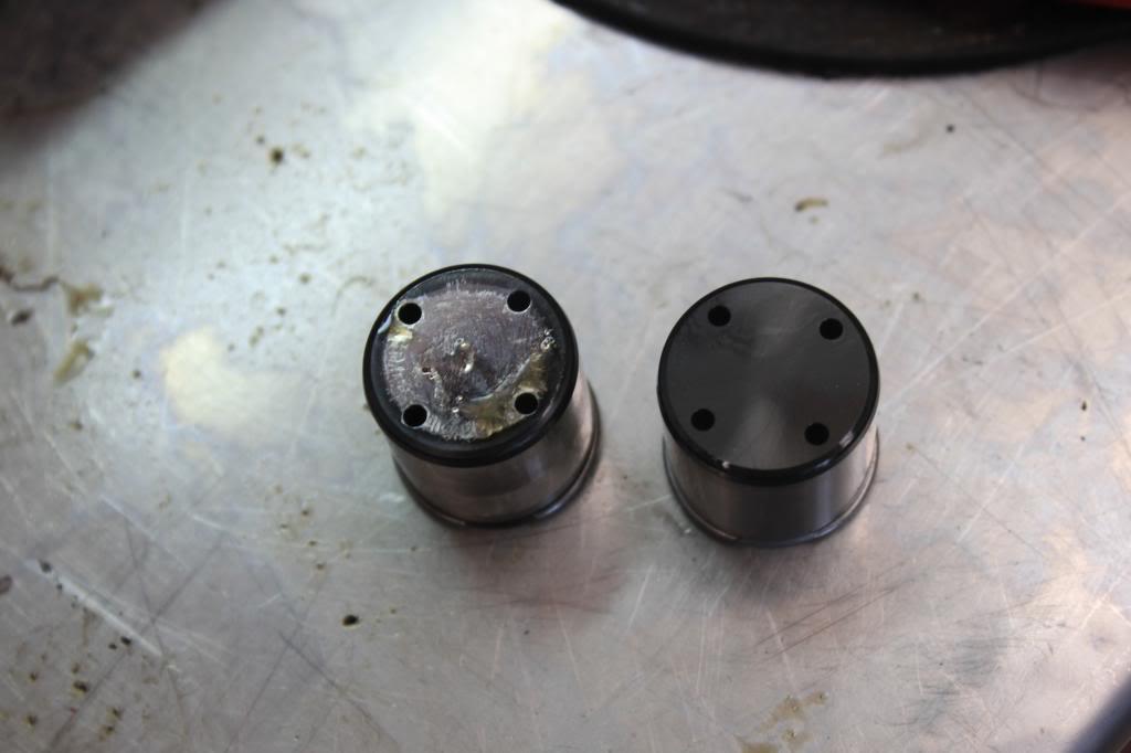

« Reply #173 on: April 18, 2013, 04:39:13 pm »
Finally got round to doing this today. Its an easy process apart from that Banjo bolt, which took forever to open and then close afterwards.
I took some pics of the removed cam follower. 101.5k on the car, had it from brand new, 55k with a Stage 1 remap.
I would say you need a camshaft  :scared:
