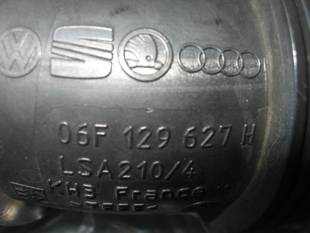

Ok, I can see it listed as a separate part  :confused:
Just to check I thing you mean the o-ring you can see here
I checked the part number of this intake pipe
And there is no o-ring listed just the pipe itself: -
[pdf]http://www.mk5golfgti.co.uk/forum/downloads/gazparts.pdf[/pdf]

« Reply #6 on: August 31, 2009, 06:19:58 pm »
cheers steve, thats a pain in the @rse, will ring the stealer tomorrow, don't fancy havin to buy the whole pipe though :scared:

« Reply #10 on: September 01, 2009, 10:13:28 pm »
I've ordered 1 now thanx Stu, you can't get the o-ring on its own, so its going to cost 20 odd quid just for an o-ring :smiley:, would like to know where the original 1 went though :scared:
