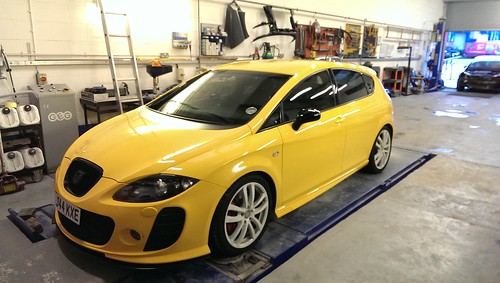

Give the car a good clean inside and out today, winter months really do take there toll on cars,
Once the air is fitted I'm planning on hitting the car hard.
The few chips it does have, keep getting blobbed in and built up with 2k paint, once they are proud they will be denibbed and then polished to become invisible,
This time as part of the polishing procees I'm using a new product,
It was introduced to us via 3m while we were polishing this
Untitled by cuprajake1, on Flickr

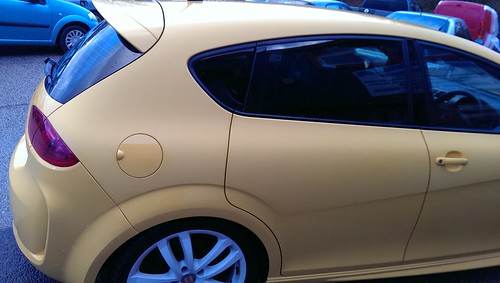

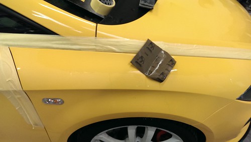

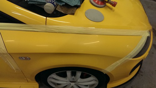

well,
yesterday i touched all my chips in with 2k paint, today i decided to denib them with 2000 paper,
then i decided i may aswell do the lot,
so test panel for smoothing out the orange peel was the wing,
first i cleaned it and then blocked followed by had flatted with wet 2000 paper.
IMAG1158 by cuprajake1, on Flickr
after that i wiped down and hit it with 3000 trizact on a da, followed by a 6000 trizact on da
this gives a semi gloss finish
IMAG1159 by cuprajake1, on Flickr
after that its the usual 3m fast cut process and a wax, this gives a really good refined and smooth finish
IMAG1162 by cuprajake1, on Flickr

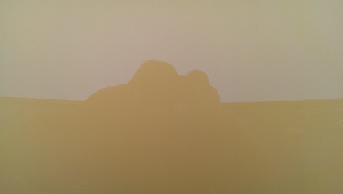

so into the car, same process cleaned, degreased, de tared etc
the car was blocked with 2000 wet, then washed
hand flatted with 2000 wet , then washed
3000 trizact with da , then washed
6000 trizact with da, then finally washed
i went over the full car giving me this.....
IMAG1163 by cuprajake1, on Flickr
IMAG1166 by cuprajake1, on Flickr
IMAG1169 by cuprajake1, on Flickr
IMAG1171 by cuprajake1, on Flickr
the polishing will be tomorrow or sat, tonight i have a cool matt yellow car :)
jake

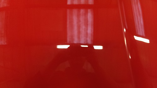

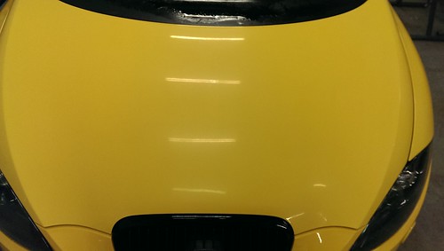

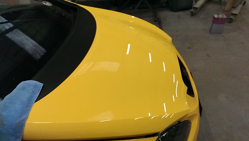

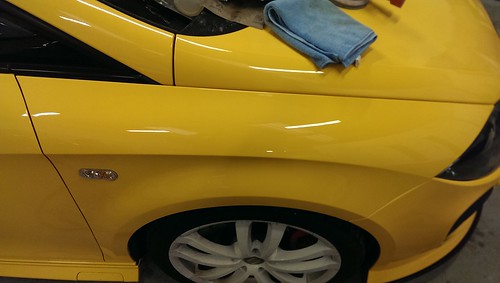

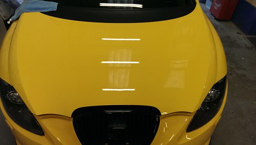

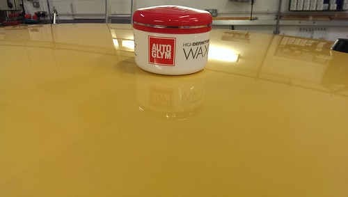

Started the polishing process today, just the bonnet.
Polishing process is as follows.
3m fast cut using Indasa yellow pad, these don't breakdown as fast as the 3m green, then i prekleen the paint and after that I use the soft 3m yellow pad and yellow top ultra fine polish, the last step it's blue ultrafina on its pad,  final part is to clean the panel and give it a coat of wax.
The result
While its not removed all the orange peel, it has considerably flattened the surface.
Jake

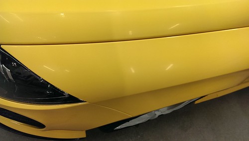

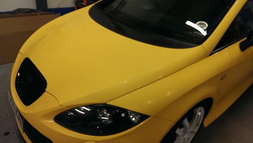

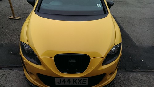

I took it a step further, I actually wet sanded the clear down removing the Orange peel effect in the paint.
The discs will remove a lot of imperfections, but not the actual finish of the paint.
I've just finished now, and the cars come out really well.
Numpty here forgot his dslr so only have a couple of pics off my phone. So hard to get any quality images really.
Pics
So in total I had.
5hrs colour sanding and trizact
10hrs machine polishing.
Quite a long process but well worth the effort.
Jake

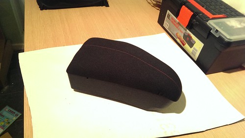

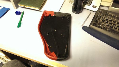

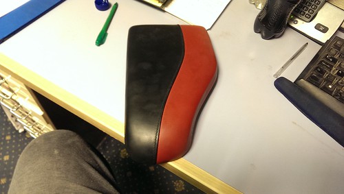

got myself an arm rest off ebay,
but they only come in leather and this one really didnt match the stock cupra seats

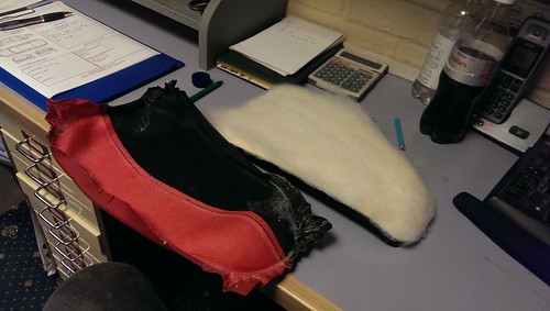

so took the top off then the leather skin

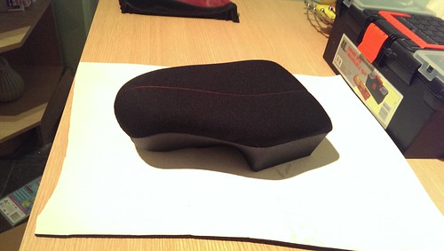

then went to a mates and got some matching cloth for my seats, went home and sewed a nice red curved line to match my trim
then fitted it this morning
IMAG1232 by cuprajake1, on Flickr
think it works really really well
jake
