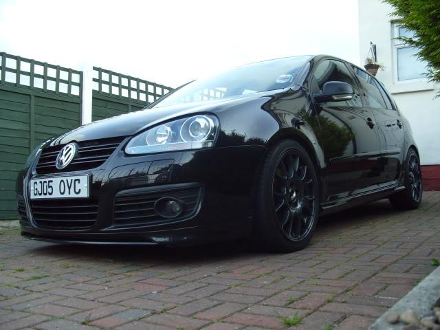

Hi guys I heard that my old golf had been wrote off so thought I'd put one last pic of it on here. RIP
Offline Matto
  • -Receive: 116
Re: My golf GTtdi Sport more door(for sale)
« Reply #411 on: November 05, 2013, 06:32:12 am »
RIP indeed. Lovely motor. Was one of my favourites.
