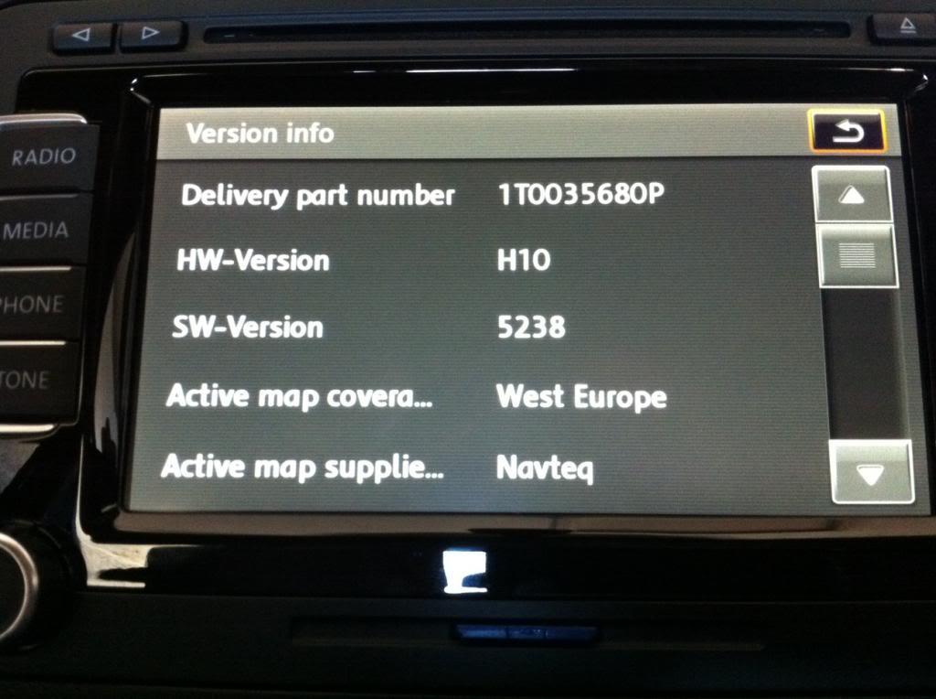

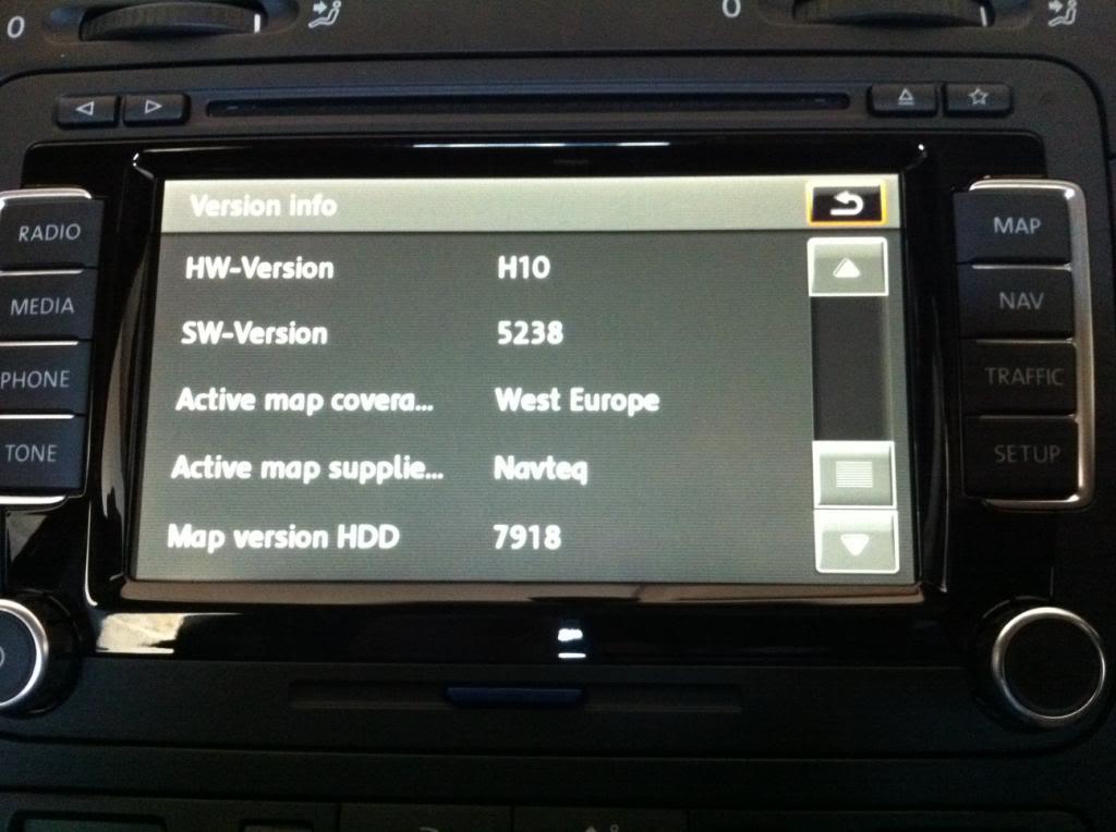

Well all went well today and the RNS is in and working  :smiley: I ended up with a version P unit as the H version i went to buy looked like it had been well used... cost me another £50 but looked almost new so im very happy with it, The unit has a production date of 07-13 so i assume it should have the latest map's although it still could be behind... would anyone be able to tell if i put up a couple of shots of the info screen. cheers.

Thanks Raz.. does this mean anything to you bud....  :wink:
Offline RetroRaz
  • -Given: 32
  • -Receive: 194
  • Posts: 2821
Re: GPS Puck positionong and RNS info
« Reply #10 on: September 29, 2013, 07:58:57 pm »
you got latest v9 mate  :happy2:
