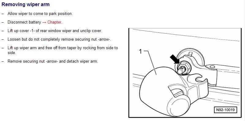

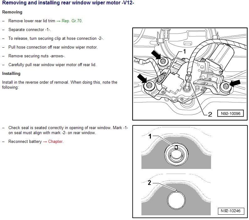

Installation:
" border="0" height="388" width="785
" border="0" height="694" width="785
