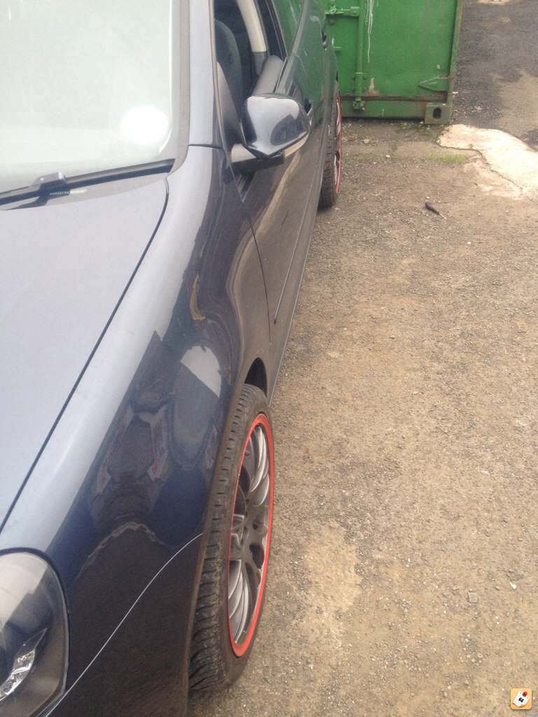

Width of the wheels 18x8jj
Here are some pictures with the wheels on

Will I be able to put 235/40/18 tyre without a problem?

Almost any tyre and wheel will fit onto the Golf if it is high enough up and the police don't stop you for the tyre sticking out past the wings.
Legally your tyres need to fit under the arches. For handling, having a Golf with 3 or 4 inches arch clearance isn't good. If your arches are an inch or 2 above the wheel you will scrape the wheels if you have more than 225/40/18 tyres on 8 inch wheels. Especially if you are running less than the minimum recommended ET45 (front at least).
HTH

Thanks for the advice. I think I'll stick to the current size I got in which is 225/40/18 to avoid arch scraping.
