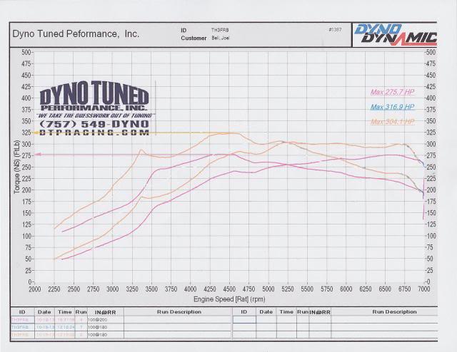

Just gave DM a shot and showing me what they can do with the K04.  I've had APR tuning since Stg 1 and never had any issues - no mis-fires and very good fuel trims.  There was a local dyno day coming up so I had a chance to get some cheap pulls in and do a back to back comparison.  I did baseline runs with APR on Friday afternoon and had them flash me back to stock. Then I flashed the initial DM K04+ file that night and went out to collect some logs early Sat morning.  DM turned around a couple of revisions within 30min on Sat morning and I went back to dyno around noon.
Here is the dyno chart with my best baseline run on APR tuning and a good run with DM. My first DM run hit 316WHP but it had some issues (maybe clutch slip) so Bronson thinks it's best to toss that one out. I P-chopped the lines off the chart. My goal was to make this as fair a comparison as possible of what APR's off the shelf tune does compared to what DM can do with some customization. The only hardware difference is a 3bar MAP sensor ($40) that I swapped in 20min.  Same dyno, same temp, same tank of gas, just slightly more humid for the DM pulls because it was overcast and we had some light rain. if anything the humidity would have hurt the DM results slightly.

So...the results: +29WHP, +45TQ
APR K04 - 275WHP, 280TQ
DM K04+ - 304WHP, 325TQ
And here's the actual boost from logs of APR and DM.  You can see that there is more at work in the DM log than just cranking up the boost.  I got 29whp and 45wtq with only 1.5psi additional boost in the mid-range.

I'm not sure where you got the impression that this wasn't an independent dyno
I have no affiliation with Driver Motorsport...aside from now being a happy customer.  This data is from dyno runs I paid for out of my pocket at a local shop I picked.  The shop I ran on the dyno at is local to me and had never heard of DM before I came in but they were pretty damn impressed with the results and asked me to put them incontact with DM to tune an Audi RS6 for them.  They happen to be an APR dealer which was nice because they flashed me back to stock after my baseline runs on Friday so I could be back Sat to run again with the DM tune.
Full disclosure - DM offered me a trial of sorts - I pay for the programmer up front.  After getting the tune I can either decide I'm not satisfied and send the programmer back for a refund and go back to my APR tune or pay the remaining balance and keep the DM tune.  This was all knowing that I was planning a dyno comparison and was going to post results on some forums.  They obviously felt confident in their product.  They were actually a bit anxious after I send initial logs from my APR tune because it runs great - said itr was the best APR K04 logs they've ever seen.

I have no idea what DM thinks they can do compared to a Euro APR tune.  I was simply trying to let you guys know about another tuning option that produced solid results for me.  Honestly, I'm prety damn impressed.  I always though APR was solid, and they probably are considering it's an "off the shelf" tune that has to work across a broad range of hardware configurations.  The big difference here IMO is the customization based on my specific logs.  I just loaded my 3rd revision last night and already have a new file waiting for me when I get home.

This to the wheels for a 2008 FSI, not TSI, not R.
Are these stage 1 maps? Usually when running TBE and HPFP they will use stage 2 maps which ordinarily in APR tune are pushing 350-360hp +.
APR are trialing a new K04 file for stage 2+ cars which I'm hoping to have installed.
