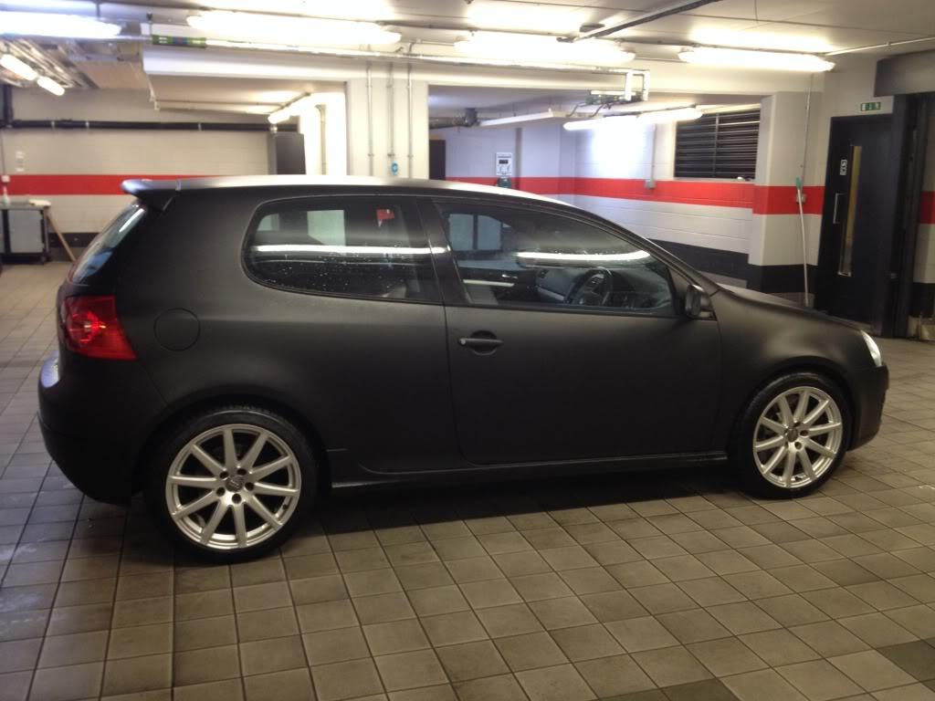

I love this stuff, went and did the whole car Matt black, so easy to spray and get a smooth coat.
WHOLE CAR..........!!!!! :scared: :smiley:
Good effort matey, would love to see pics of that and know how much you used too! :party: :happy2:

Will get some pictures up for you, I paid £200 for for the whole kit from mattpack.co.uk, including electric low pressure spray gun and 10litres of prethinned plastidip, they sell the rubber dip s now though which means you can do a whole car in three coats
