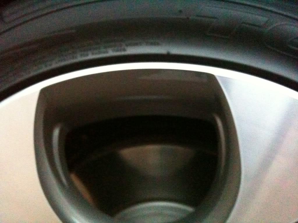

« Reply #4 on: September 16, 2009, 07:23:00 pm »
Basically dude this is how a genuine set should look:

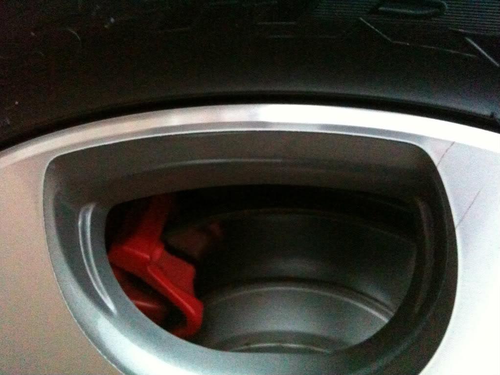

And this is how a refurbed or rep set would look, there could also be the chance that the lip is completly flat so imagine it without the taper and just the gastly cut.
Hope that helps.
