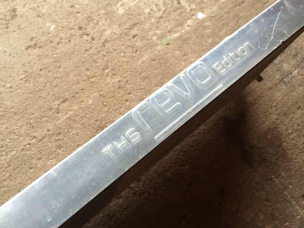

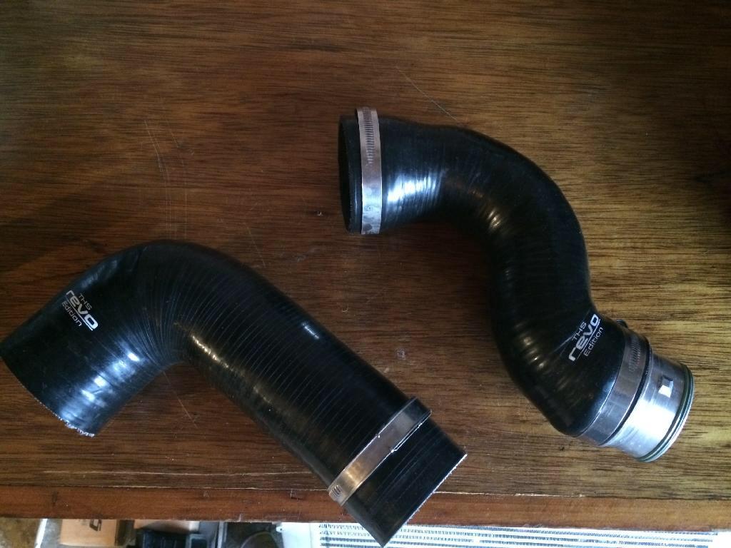

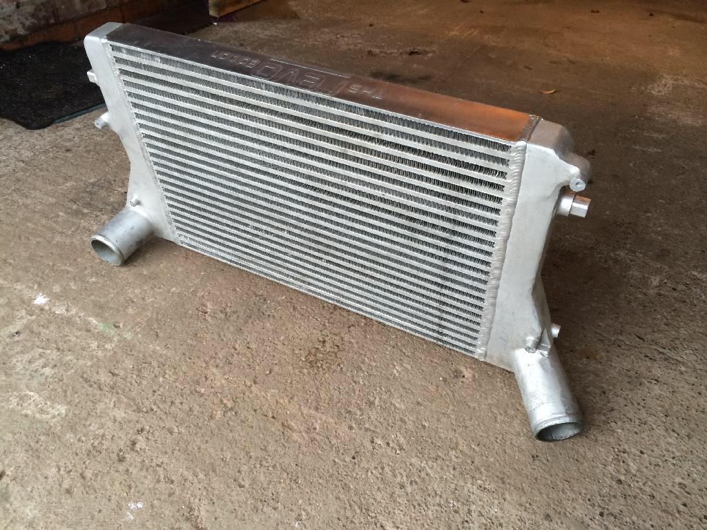

THS Intercooler
I decided on the THS FMIC (Front Mounted Intercooler), from what I've read it seems to be one of the best. Luckily enough for me days before I was going to buy a new THS one, one popped up in the For Sale section on here, happy dayz, always up for saving a few quid!!
Its a THS REVO Limited Edition one, apparently REVO bought a load of THS IC's and branded them with their name along with the THS logo.  :confused: It needed a few bits doing to it but as always Alex at AKS sorted this out (fanks fella  :ashamed:).
The THS Front Mounted Intercooler......

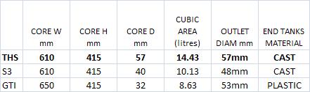

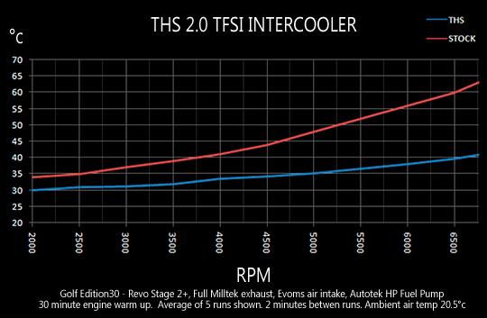

Graph comparison between stock and the THS....
Core size comparison to S3 and Stock GTI IC's....

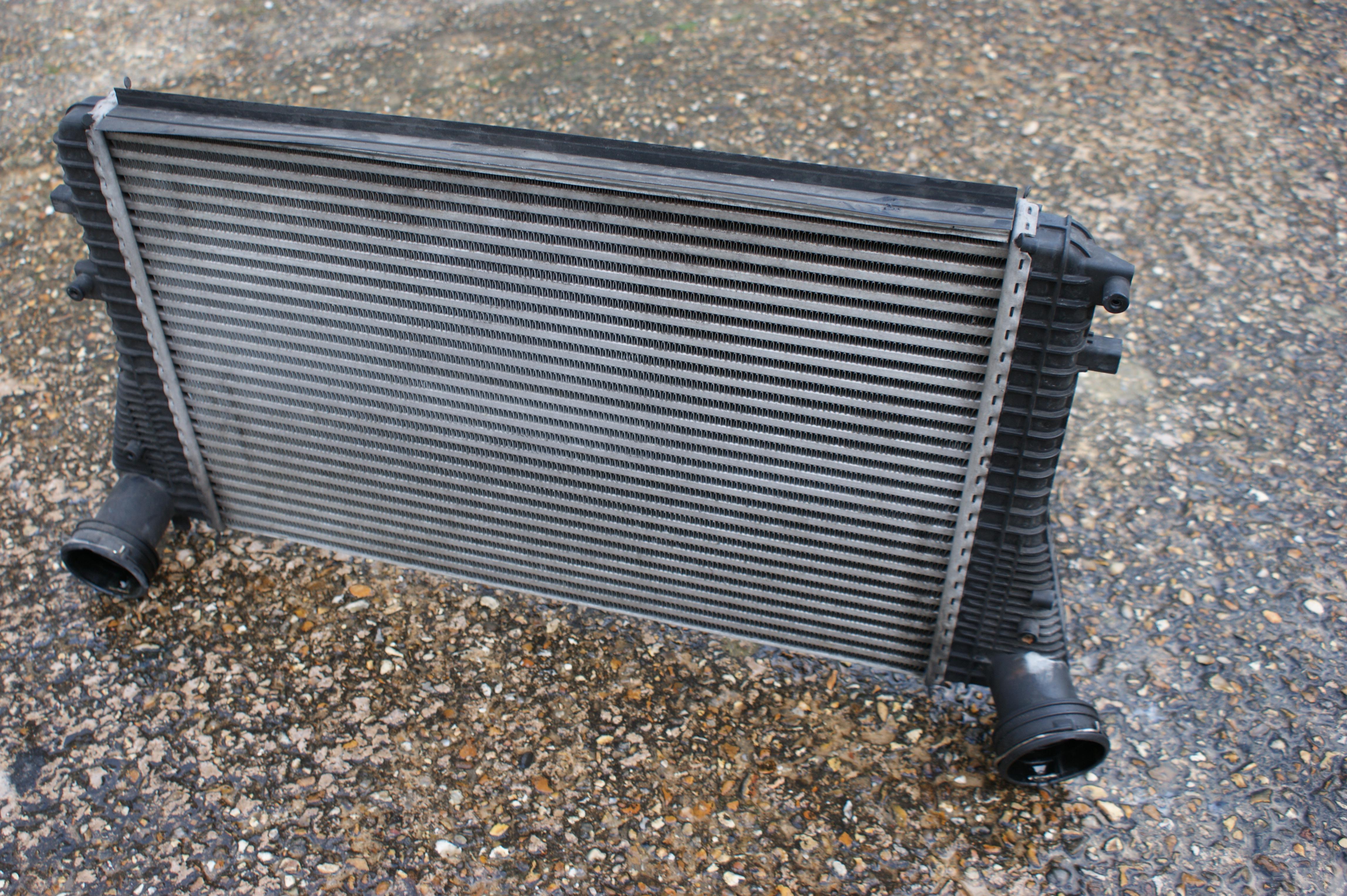

off with the Old.......
And on with the Big Arse new one.......

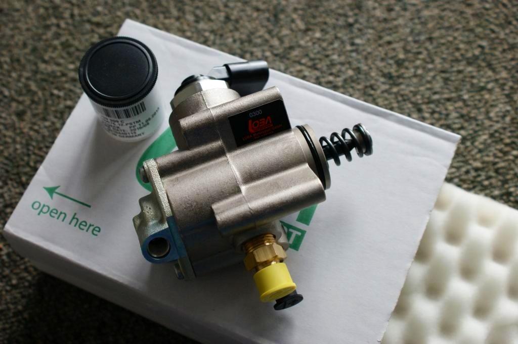

LOBA HPFP
A new High Pressure Fuel pump was added to. Was a no brainer to go for the LOBA one, its way cheaper than the ARP one and I've read nothing but good things about them. It even comes with a new Cam Follower which is a very good idea and something that APR should have considered (along with dropping their ridicules price).
LOBA's site.....
~~ Clicky here ~~
Taken from their site........
"We take a brand new factory OEM pump for reliability, then we make fundamental changes using new components and processes by LOBA to create this upgrade fueling solution. Also Included with this upgrade are OEM Cam follower and OEM Pump O-ring seal.
Modification and tuning of the 2.0TFSI engine way beyond OEM power levels requires an extra volume of high-pressure fuel. The LOBA 2.0 TFSI high pressure fuel pump will give a fuel volume increase of more than 50% and can sustain over 135bar making it the one of the biggest flowing pumps on the market. Also suitable on a stock software car.
The LOBA uprated fuel pump allows much more power throughout the rev range but specifically in the midrange on cars where the stock pump is insufficient.
The materials and processes we decided upon are of the highest possible quality and for this particular application, this meets the very high requirements needed for the latest generation of OEM HPFP specifications. Multiple stages of various precision machining, hardening processes, coating processes and quality control inspections characterize this LOBA pump.
Tested to over 8250rpm both in a controlled environment and on the track/road to simulate a large range of dynamic conditions. Doing so was an important part of our mechanical design parameters to ensure the LOBA pump meets our standard. Results are reliability, durability and performance."
Dodgy iPhone pic.....

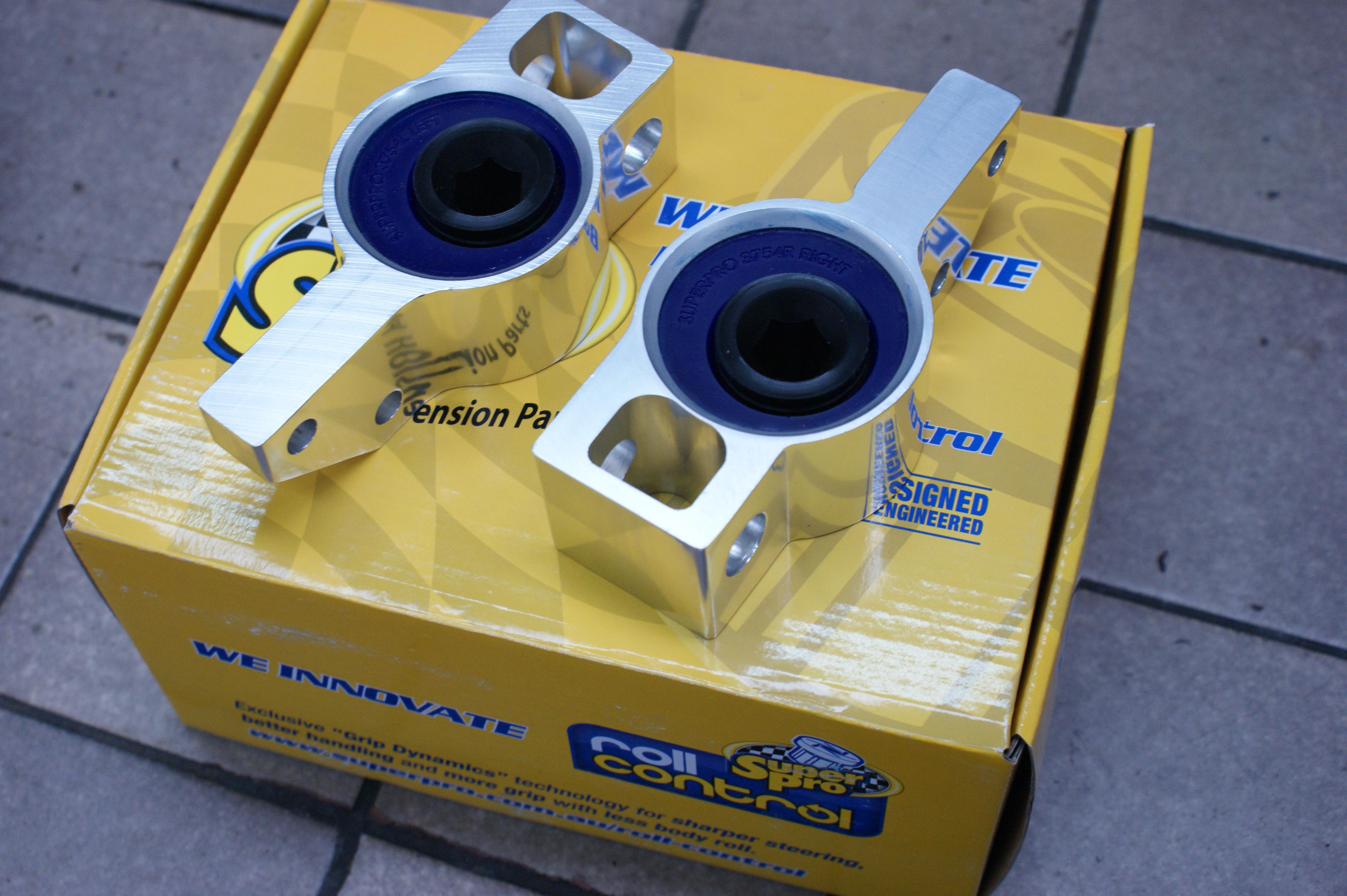

Front Wishbone bushes (SuperPro Control Arm Lower-Inner Front Kit)
Part number SPF3346K IIRC these ones are the 90k not the 80k ones.

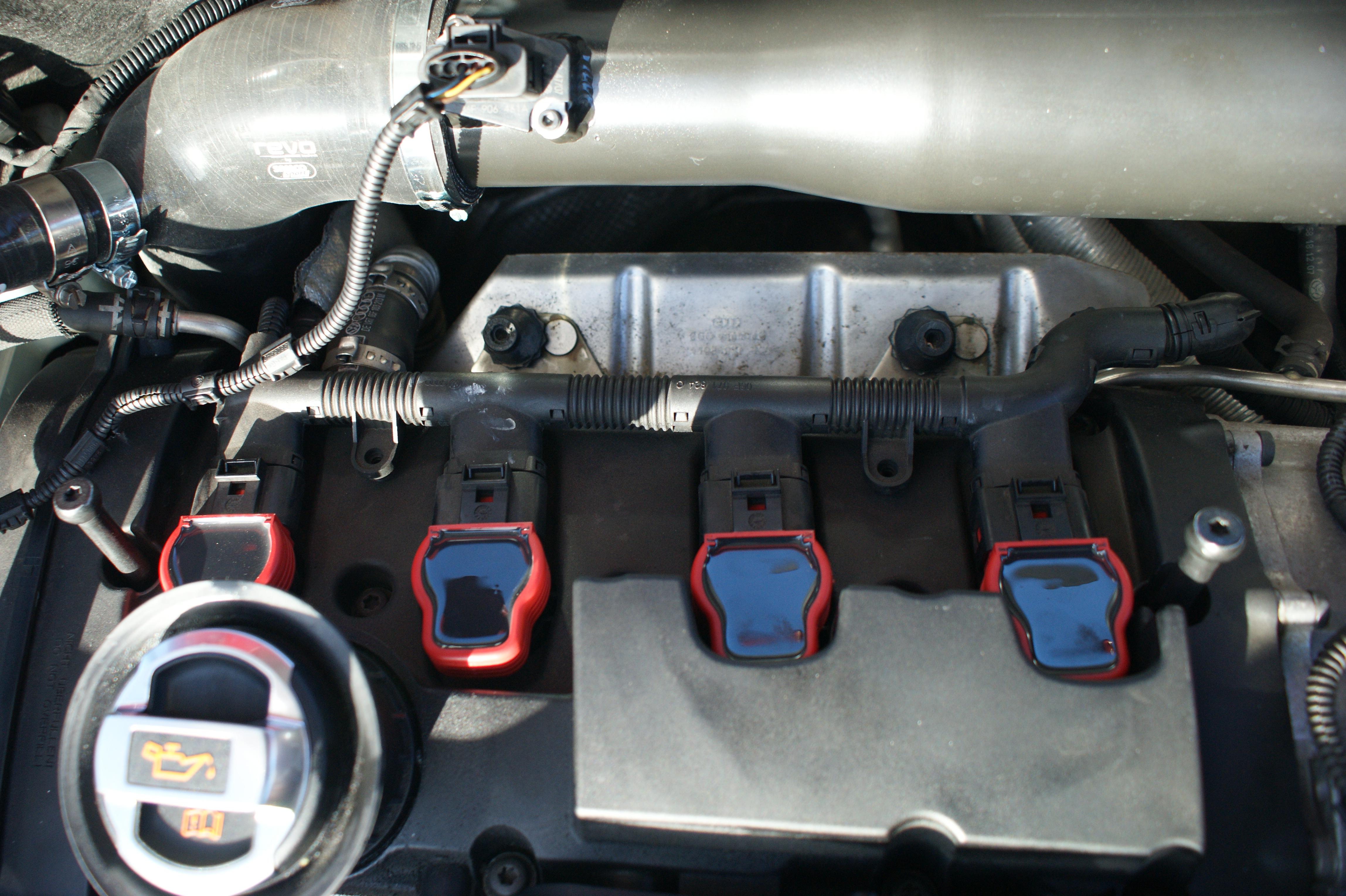

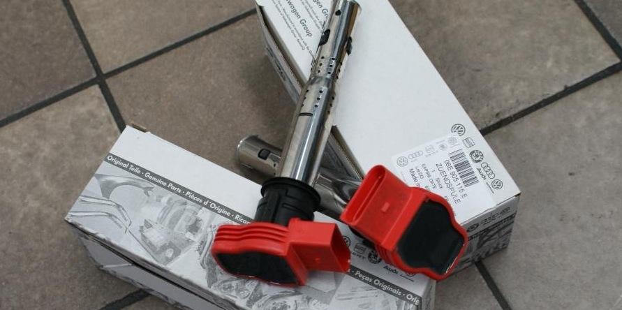

R8 Coilpacks
Updated/uprated my Coilpacks and plugs at the same time. Heard lots of good things about the R8 Coilpacks but to be honest, their red so end off. Supposed to help reduce the chance of misfires on tuned T FSI engines etc etc etc.
Audi R8 Coilpacks Part number 06E 905 115E
