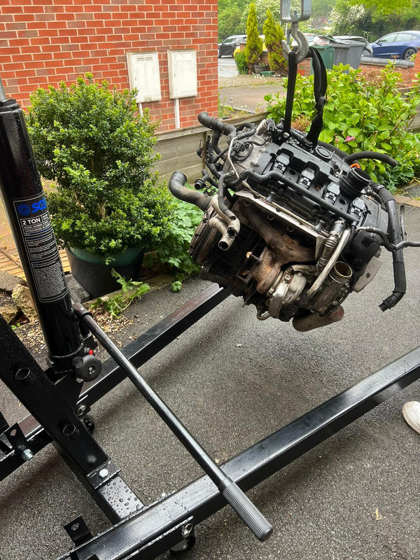

Hey Pudding, I took off the AXX engine yesterday and dismembered the DSG, it does look like its a straight swap now its all apart. Ive seen in a post previously that I would need to transfer some sensors from my AXX to the CDL, is that still the case?
