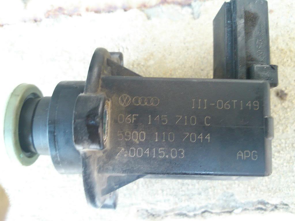

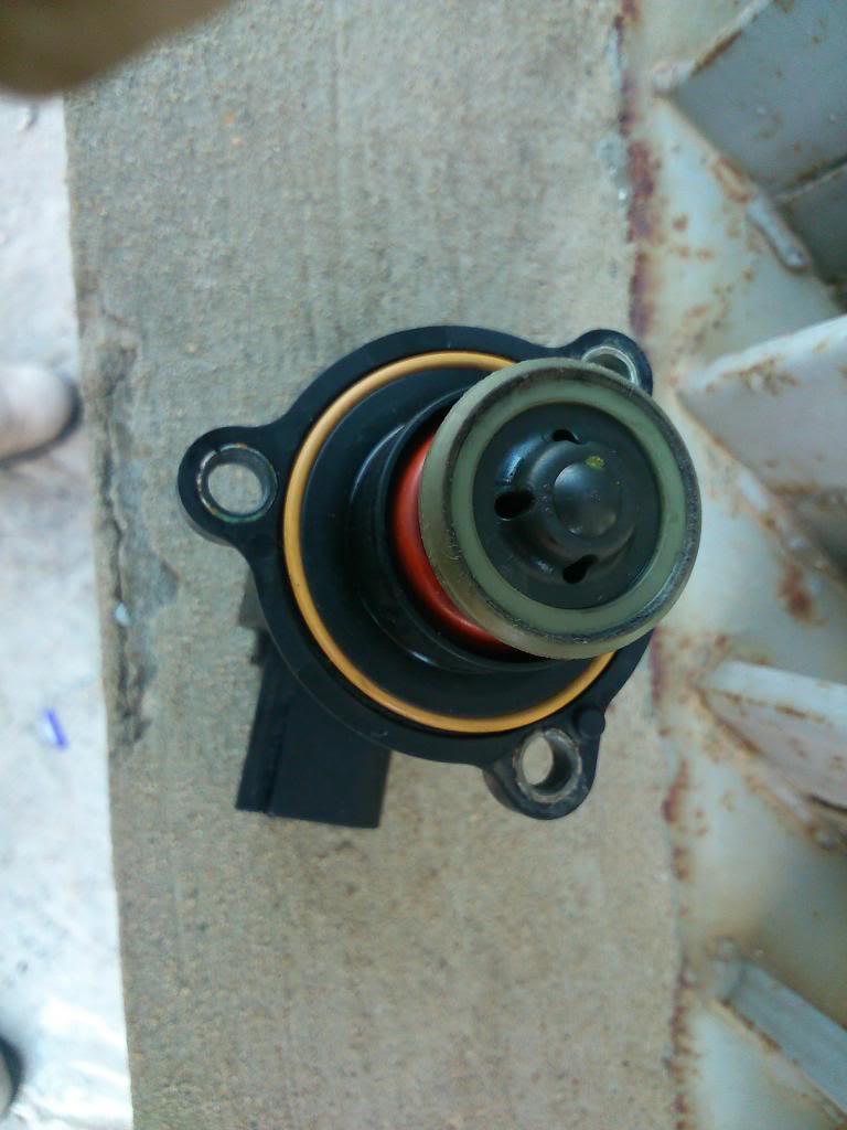

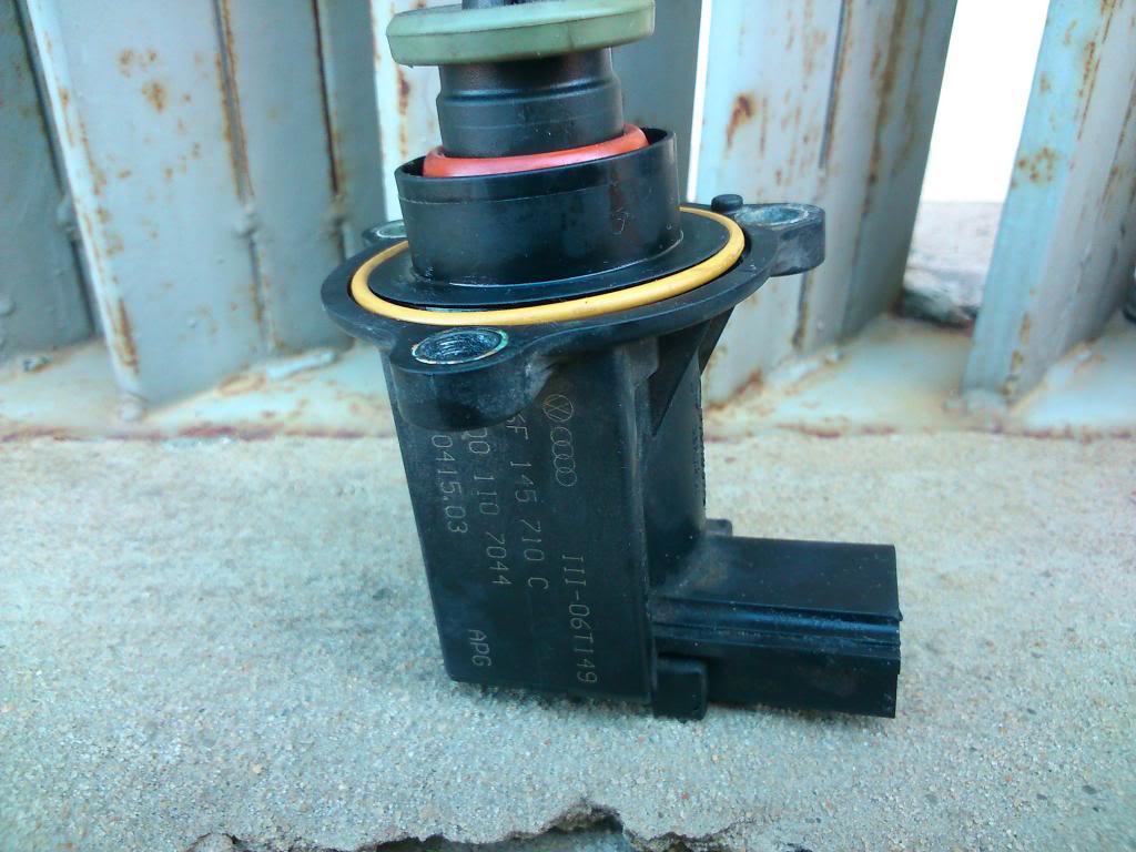

i took pictures for the DV when i remove it ,i took it out and checked the diaphragm and the rubbers look fine no scratch or crack it is opening and closing properly as well.
is it possible that the DV gives such error even if the diaphragm look good? here attached the pictures[/img][/img]

here we go attached the pictures

It's not that we don't believe you when you say it's ripped. It's that rev c is quite old and should be replaced anyway  :happy2:
Those pictures show nothing of interest.
