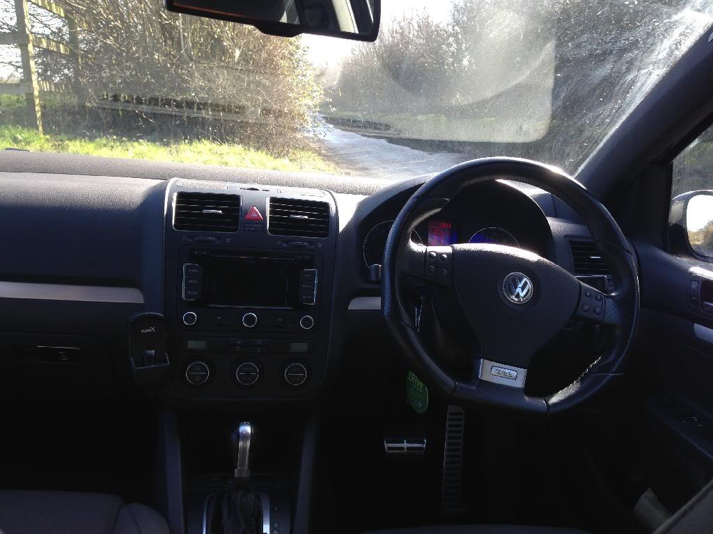

Hi. I'm new here and have just bought my first golf. A late 2004 GT TDI 2.0. Loving it so far. Want to upgrade the stereo and was thinking of the Rns 315 as it has Bluetooth and dab built in. I know I will need GPS antenna and DAB antenna but my question is does my car require the Can bus upgrade for this stereo? Sorry if this has been asked elsewhere. Could only really find info on the Rns 510. Many thanks in advance.
