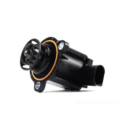

Just ordering a dv for my gti ! its a 2006 ko3 , which part number do i need for the best DV ? is it revision g or d i need ?

G: no boost leak, and will last fine up to stage 2

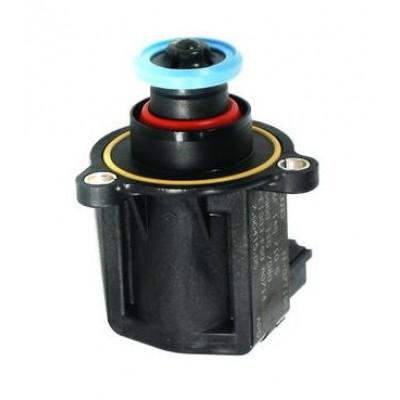

REVISION G .... Still uses rubber solonaoid and is 40 quid
REVISION D ..... Uses a piston that will never wear ? and is 60 quid so must be the better surly ??

I'm K03 and running a Rev G and it is alot better than the D. The D leaks as it doesn't make a perfect seal and gets worse over time. Just get the G and check it at every service and change when needed

The G is still prone to tearing, I've gone back to a D.
In the past I advocated the G but not after this recent tear.

Everyone even Niki at R-tech recommends a rev G valve.
If you want to buy a D then you can, it's a £40 part and takes 15 minutes to replace, i view it as a yearly consumable.

If you have a K03 based car, then take the DV as being a serviceable item.  Check every year and replace if necessary.  The K03 have the DV sat on the turbo so goes through many hot and cold cycles whilst having oil sprayed on it through the turbo.  Rubber and oil and heat don't mix well and then the valve tears.
