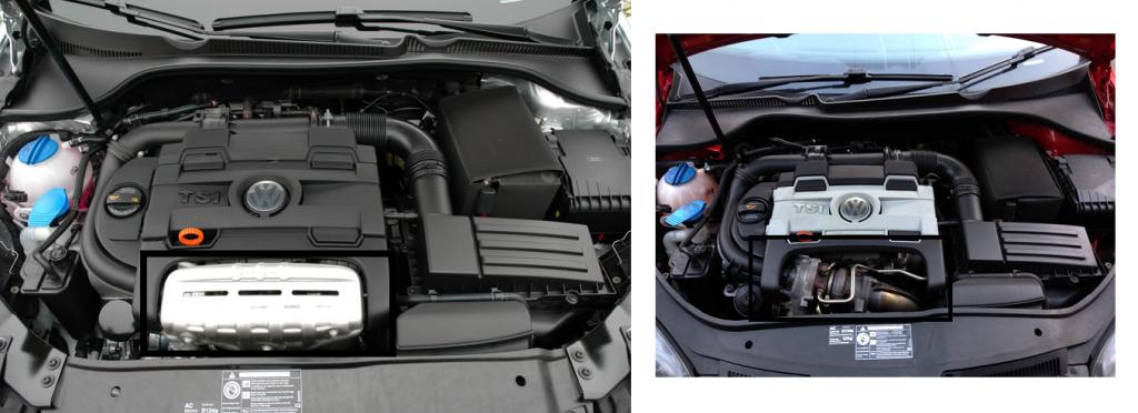

I noticed the other day when searching around for pictures of Aftermarket Intakes on 1.4 TSI Engines that my Engine bay seemed to be missing a part and wondered if anyone could advise me of what it is and if I can purchase it anywhere.
Pic below of the engine on the left with the part marked and my engine on the right without it

Turbo heat shield bud  :happy2:

its a heat shield to stop you burning your self on the turbo when you open the bonnet , it will still be hot but not as hot as the turbo and also I expect it protects the bonnet paint from damage I would fit another one asap , don't think it will effect the running on the engine

The item you want is 03C 253 041 AL - warm air deflector plate - £36:88 full retail inc vat  from the dealers if that helps at all. :happy2:
