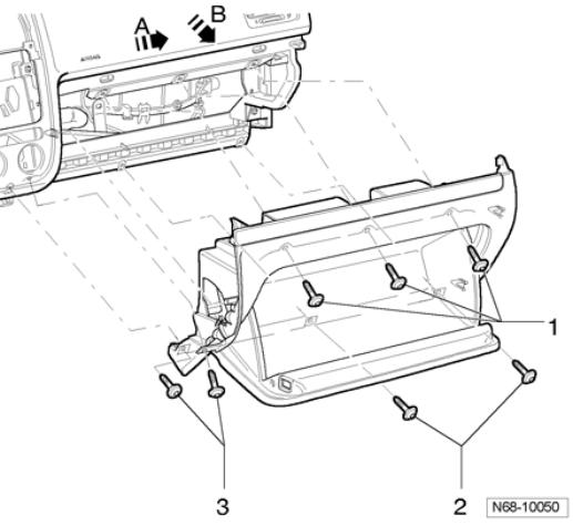

Hi
I think i managed to break the switch by not putting the key in far enough before turning.. Doh.
Does anyone know how to change it and the part code for it?
Thanks
Mat

easiest way to get to it is to remove the glove box from the car
theres 3 along the bottom (outside of the glovebox), 3 along the top (inside of the glove box)  and there is one torx screw hidden just above the ash tray you have to pull a plastic cover off to reach it
