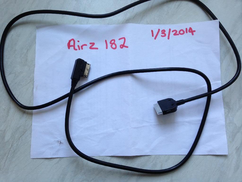

Just fitted my rcd510 stereo, bought mdi cable of ebay,
Realised the cable has no where to plug im on the headunit, after searching through previous posts,
Im i right in saying i need to install a wiring loom??
Or ive come across the plug on ebay 111259382497
All i want is my track names to be displayed on the screen and to be able to skip tracks via the stereo

Offline Airz182
  • Posts: 367
Re: Fitted rcd510...
« Reply #5 on: March 26, 2014, 11:27:00 pm »
Just have this lead:
But theres nothing for it to plug into on the back of the rcd510 headunit
Instagram- airz182
Offline Eddie-NL
  • Trader - 2014
  • -Receive: 298
  • Posts: 2639
« Reply #6 on: March 26, 2014, 11:35:16 pm »
what you have is an extension lead
to fit an MDI you need
MDI Loom > MDI Box (armrest type or Glovebox type) > Ipod / USB Lead
so to fit an mdi you need the MDI box and MDI loom
I have MDI looms & MDI Glovebox Boxes
Cluster and Key coding
Location Great Yarmouth
