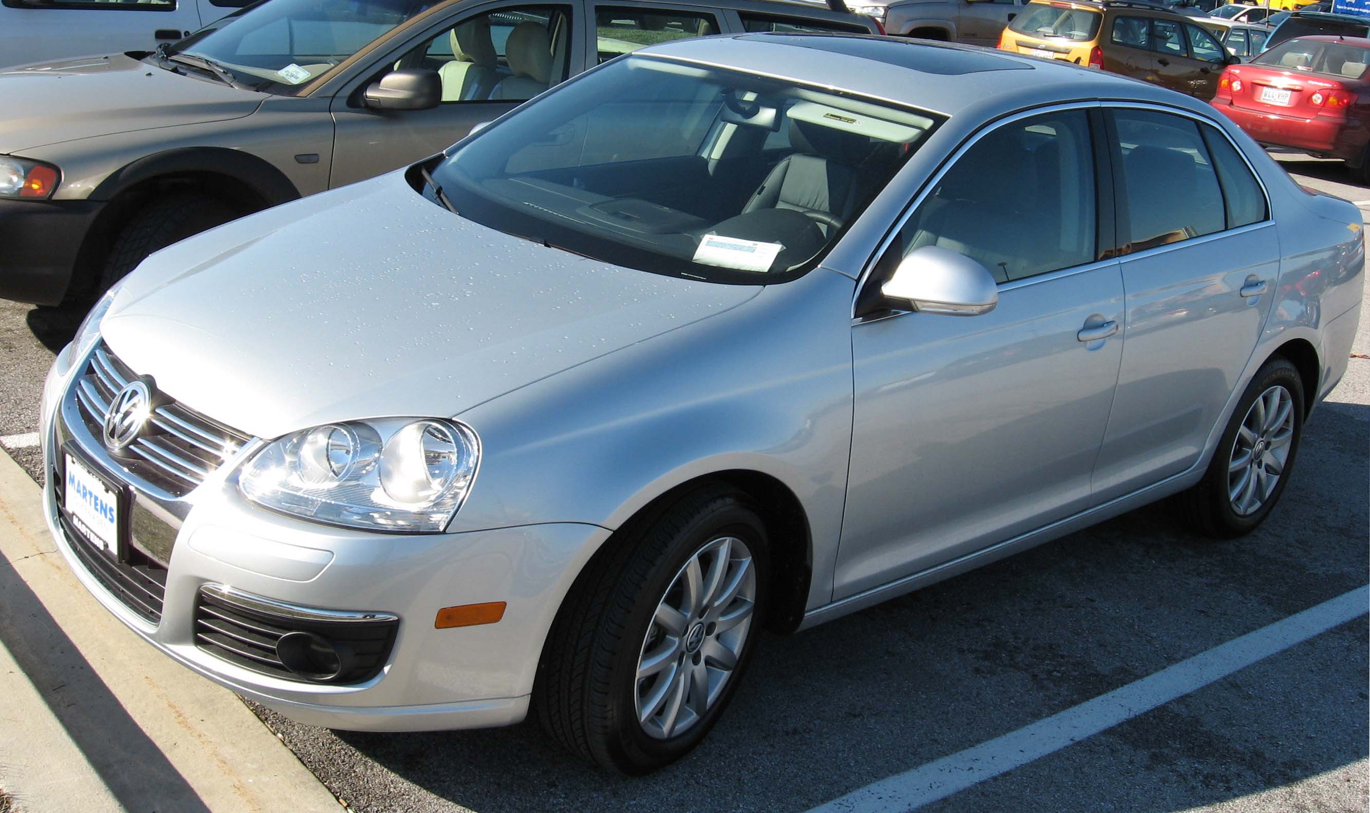

 jetta has a line on the top of the wing. And golf hasn't.
So yes they will def fit but def wouldn't Mitch the shape on the top as it has a line that goes from the door.

Correct. Same fitment and dimensions etc. but the Jetta wings have a crease line from front to rear (which continues along to the rear of the car).
Like this one.
