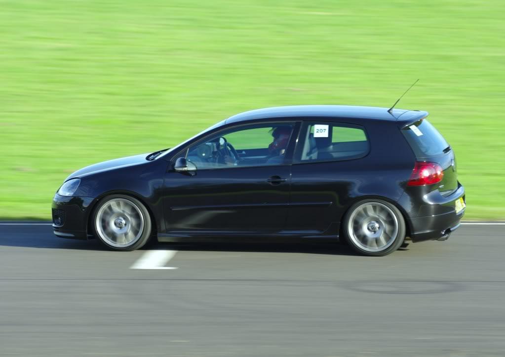

I'm pretty sure this is you.
I am guessing this is one of the very last track sessions as I only have the one. :ashamed:

« Reply #6 on: October 12, 2009, 08:13:26 pm »
Thats a great picture Hedge

« Reply #7 on: October 12, 2009, 08:20:02 pm »
x2 superb
on its arse , RSC exhaust pelting round a track = MSportman  :signLOL:
Yeah that's me alright :grin:

If you PM me an email address I will send you a higher res version. :smiley:
