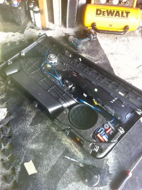

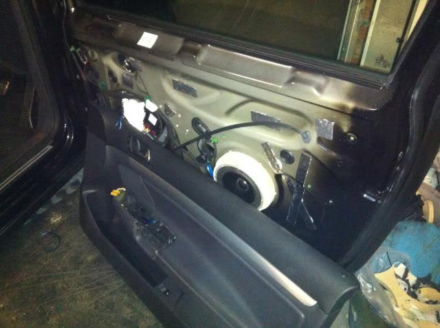

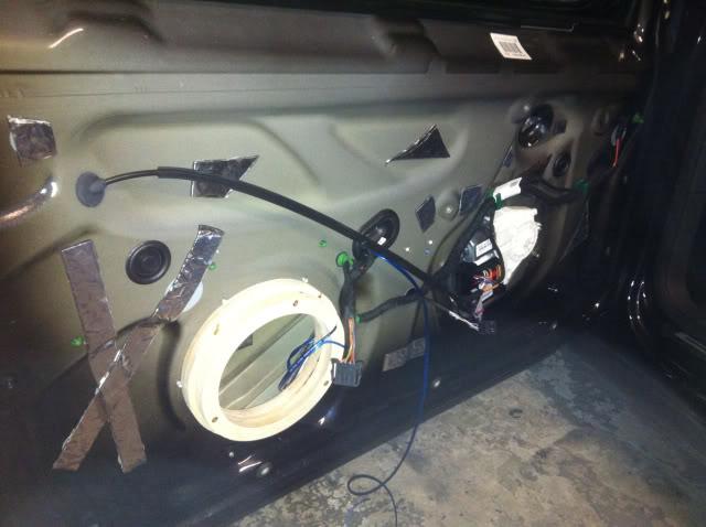

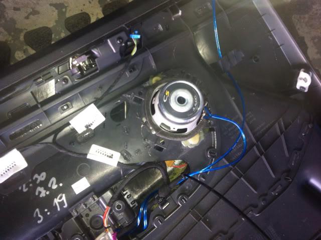

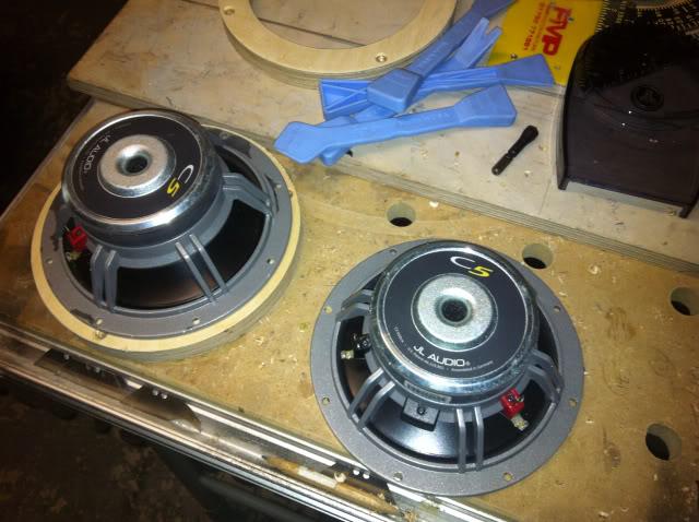

I can confirm they do fit with some fettling - and are now in lol. Pics to follow...

« Reply #2 on: March 23, 2014, 11:02:15 pm »

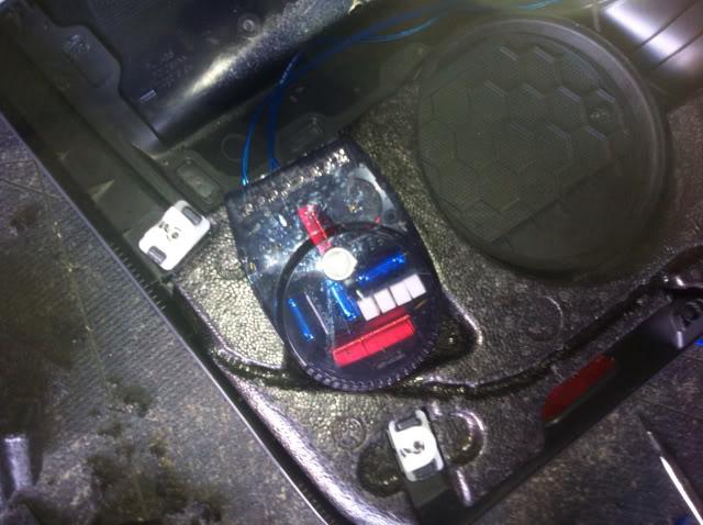

The crossover is set to attenuate the tweeter -3db, while the mid is set to the middle level.
