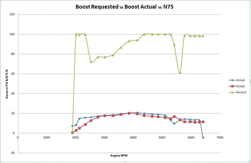

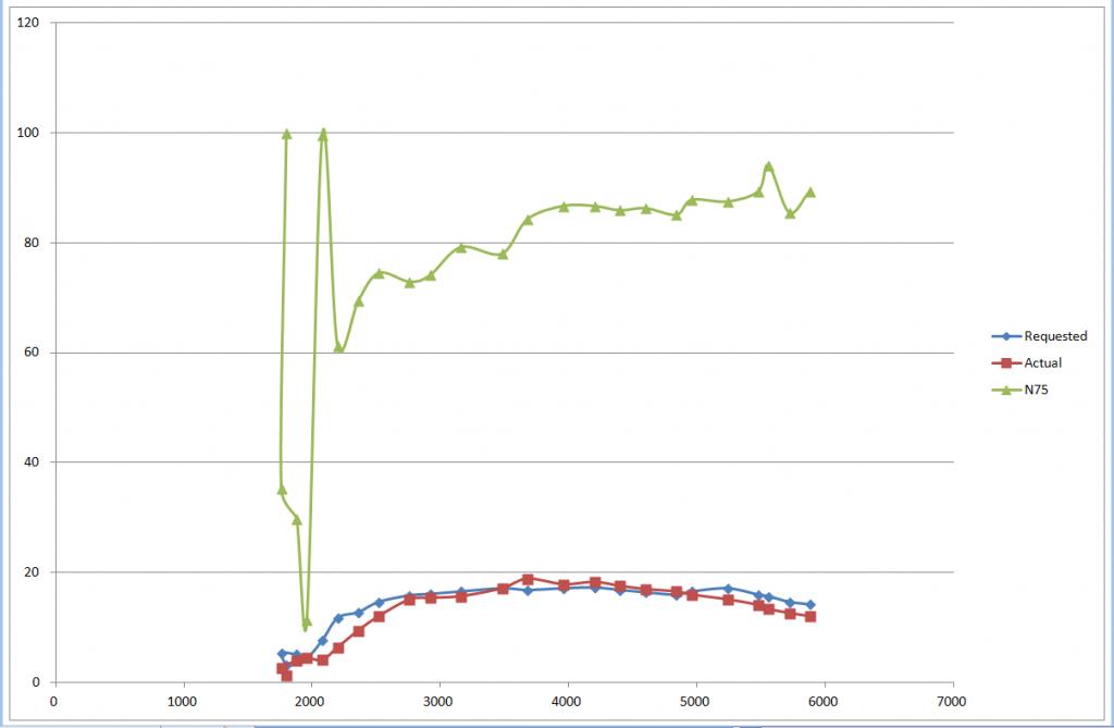

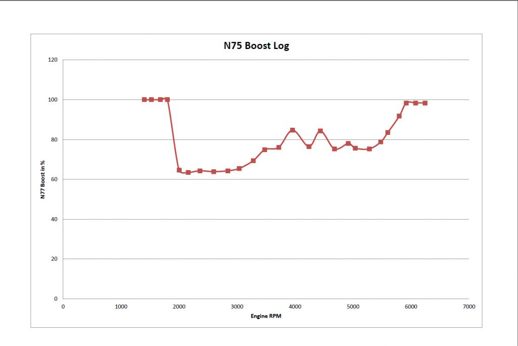

So went out tonight and did two N75 runs, both look very different. First one look pretty bad as it drops all the way down to 63.5% but then the second one looks pretty decent. Can anyone shed any light what might be going on. Both 3rd gear pulls to redline (approx)

Correct me if I'm wrong but it should never be 100% that means the turbo is working as hard as it can...
I was always under the impression that a duty cycle of around 75-80% under full throttle should be what you have..? That was when it came to diesels however.

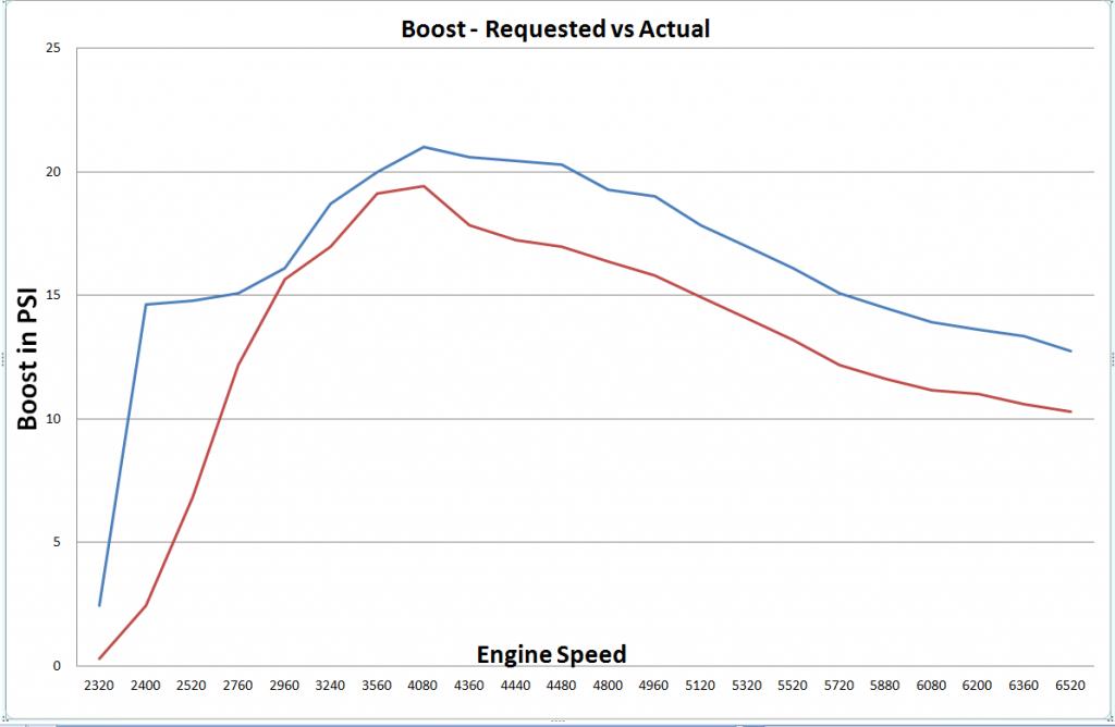

It should be @ 100% till it hits needed value and then should try to maintain (85%-95%). but both logs are very different. Here is the boost log, Requested vs actual for second graph shown in PSI. Wierd?

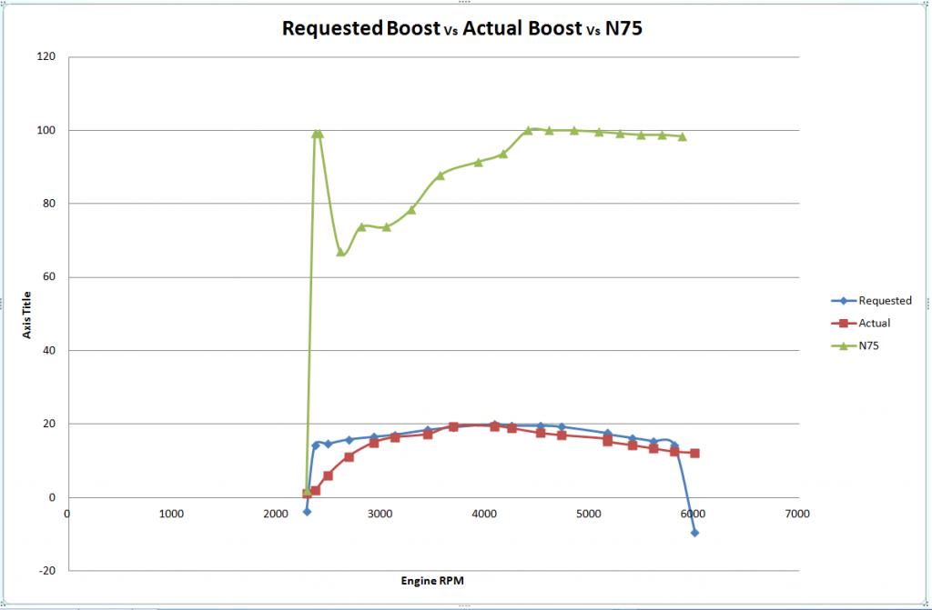

Did another 3 Runs tonight and logged. It seems to be making close to requested Boost now, (which is strange as it was quite so way off the other day) but the N75 shouldn't be going to 100% as often as this....so weird  :confused:

Go get a smoke test done. It should show you where the system is leaking boost.

Things such as temperature and air pressure can alter make a big difference on how the engine performs. Id really get it put on rollers to get it logged. If you are in leeds, rtech are only an hour and a bits drive away. If you had a boost leak you would get a fault code of P0299 of underboosting. I had this fault but it was the map rather than hardware.
