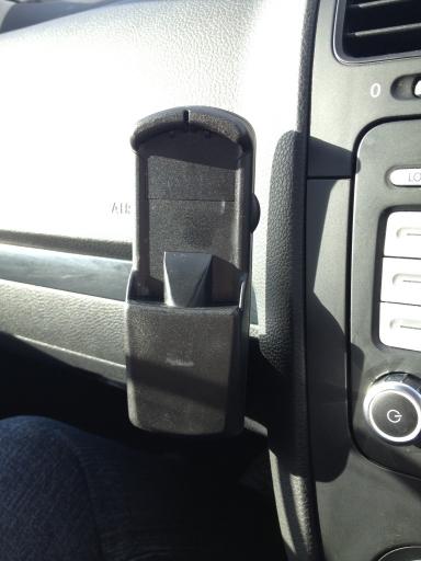

That is a good question. Usually there is what looks like a phone cradle mounted round the glove box area and if you're lucky it will have the adapter - if you do you/re half way there but you'll still need the interface kit.

The car did originally have a cradle which I had seen in the photos on the VW dealer's advert but it was gone by the time we looked at the car.
I never gave it a thought that there might be residual components until I found this Bluetooth module.
By interface kit, do you mean the 7P6 module?
