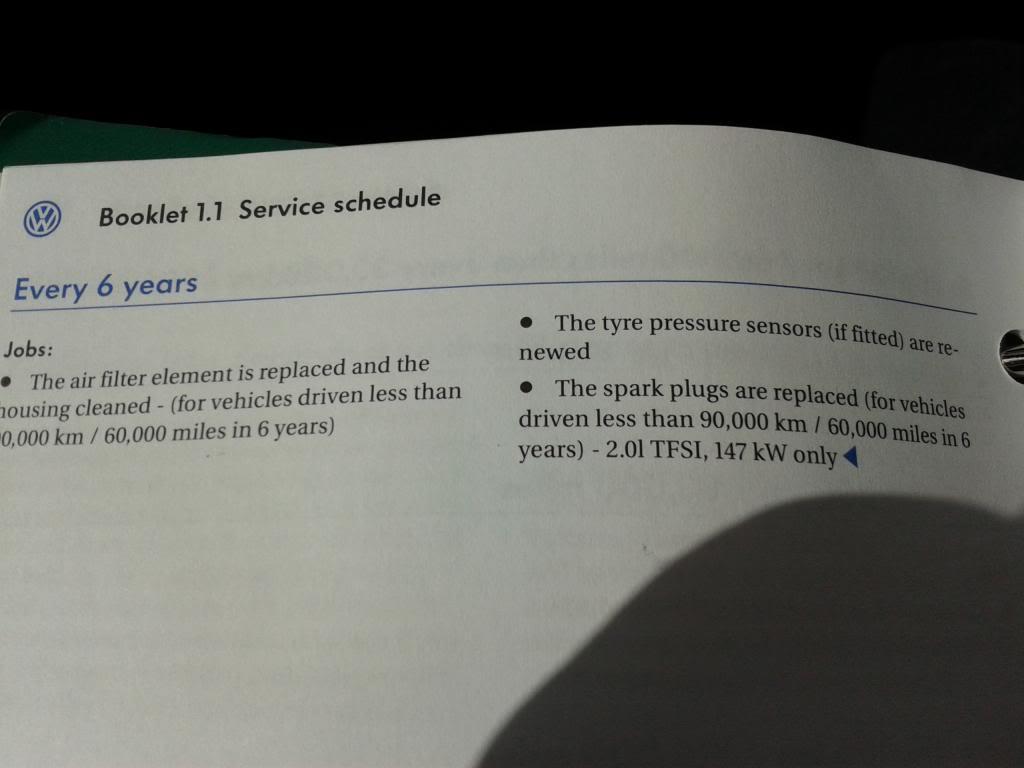

Yeah I know, I thought it was strange. I checked the manual though and in the service section it defo says it needs replacing after 6 years.

« Reply #20 on: May 10, 2014, 03:35:16 pm »
Are you sure it isn't talking about the puncture repair bottle of snot? That needs replacing after a certain number of years.
No it's not that stuff. Here's a piccy:

« Reply #21 on: May 10, 2014, 03:38:19 pm »
That reads like a different system. There are no tyre pressure sensors on mine, it's just a monitoring system rather than a pressure sensing system. Perhaps they have a 4 wheel valve pressure system on some higher spec cars?

« Reply #22 on: May 10, 2014, 03:45:12 pm »
Yarp, maybe that's it then.
