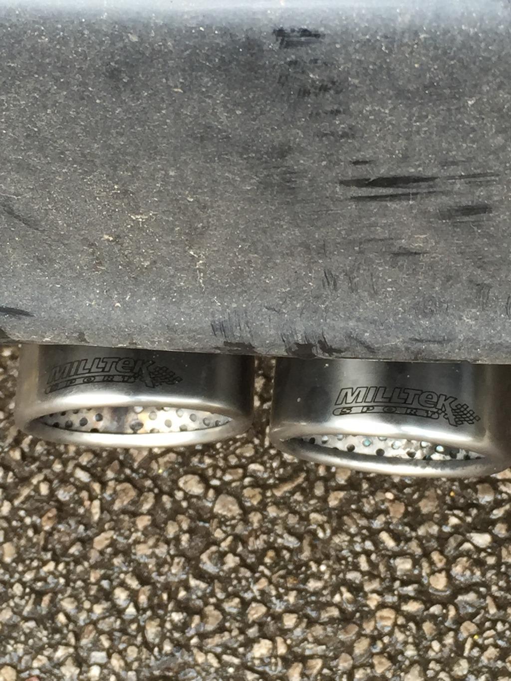

« Reply #142 on: April 14, 2016, 05:19:54 pm »
Excuse the dirt.
Full Milltek turbo back system fitted. Bonus no CEL on my dash!
Oil pick up pipe replaced.
VCDS Hex + Can purchased.
Looking at uprated engine/transmission and exhaust mounts now to hold everything in place.
« Last Edit: April 14, 2016, 05:24:44 pm by bbfb10 »
Full VCDS Hex + Can.

Nice. How is it? What system did you go for?
Offline bbfb10
  • Posts: 535
Re: Bens Black GTI - Advice Needed.
« Reply #144 on: April 15, 2016, 09:00:52 pm »
Hi @Mike58
I got a 200 Cell Milltek downpipe from @bluo and a Resonated Cat-Back from @howie1987
System sounds nice to my uneducated ears. Probably a placebo but the car seems to pick up speed faster too.

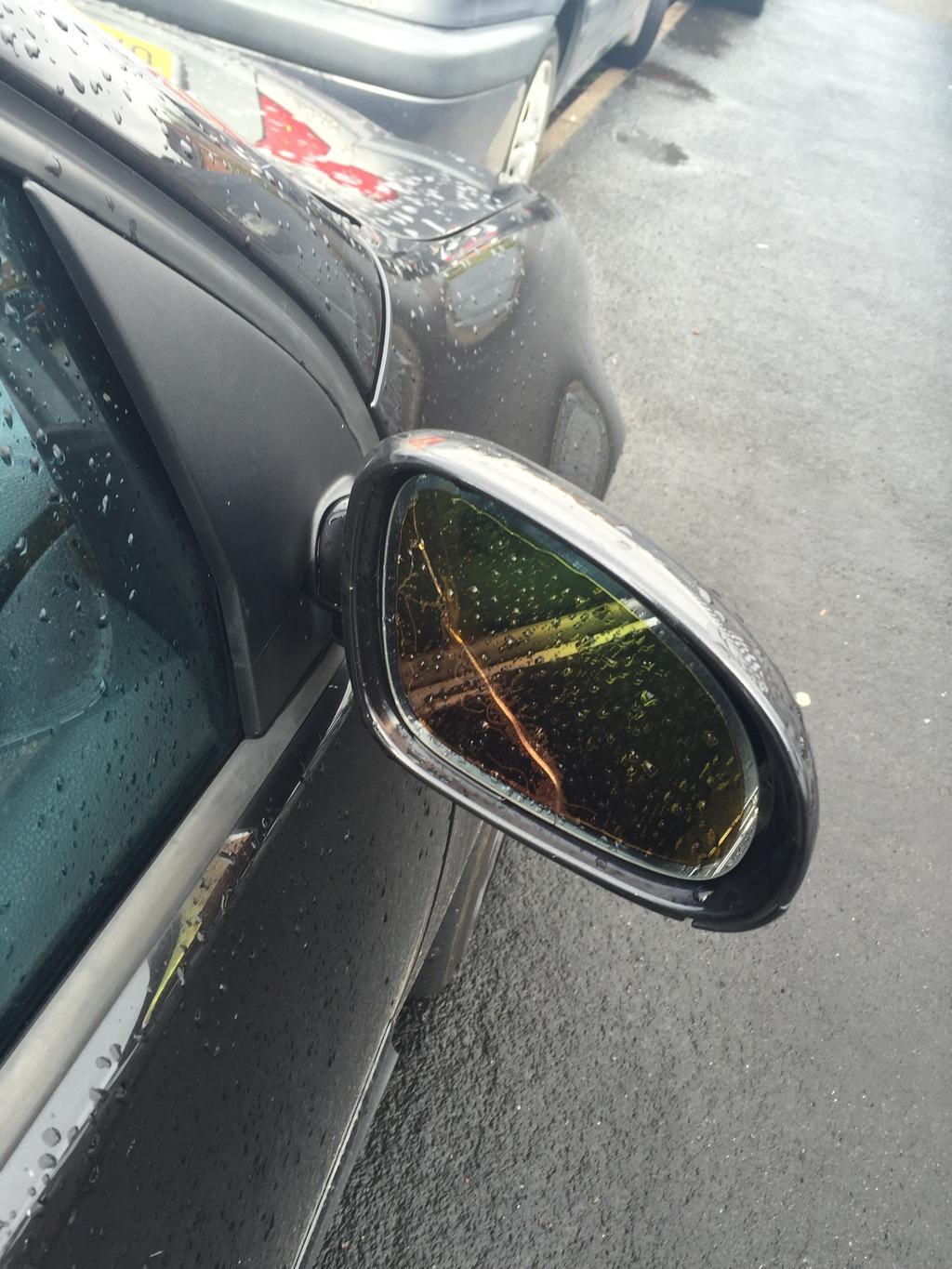

Came out of a clients house this morning to find this:
Not sure what happened, but as its opposite a school l can only assume its one of the little darlings from there.

« Reply #148 on: May 18, 2016, 02:16:18 pm »
That's an expensive mirror to replace... :sad1:
Offline bbfb10
  • Posts: 535
Re: Bens Black GTI
« Reply #149 on: May 18, 2016, 03:33:13 pm »
Second one in about 3 months. Fuming!
