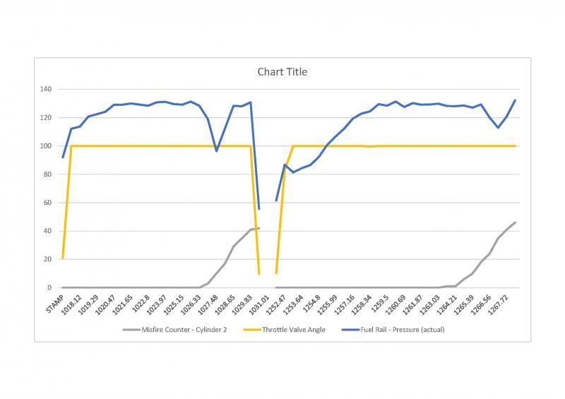

The excel spreadsheet is 2 WOT runs with a line break in the middle.
Not sure how VCDS refreshes misfire counts but you can see it goes up with the revs to 42 on the first run and 46 on the second. Both on Cyl 2 with a few on the the others (maybe caused my cyl2!?)
Changed fuel filter this weekend - no change
Plus, very unlikely to be injectors - changed all 4 to new ones last bank holiday

Is the rail pressure drop causing the misfire or caused by the misfire?  :confused:

Bit beyond my know how now mate.
Seems the fault lies in the wiring +/- ECU Id think.
Seeking expert advice is best if you want sure fire way to rectify. Alex @ AKS would be my first port of call, very very busy man though but he knows his biz!
