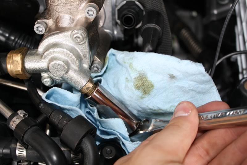

Can anyone please tell me what spanner size I need to undo the gold nut on the left hand side of the pump please.

Just making sure you know, you dont have to remove that to fit new cam follower  :happy2:

I'm just thinking about taking the APR pump off and going back to the standard pump.

or:
"Thrust sensor (G410) is the one on the left of the pump, not the one above the HPFP (it is the N276, FP regulator of the HPFP).
You can use 24mm key to get it out and try to borrow one from a friend"
