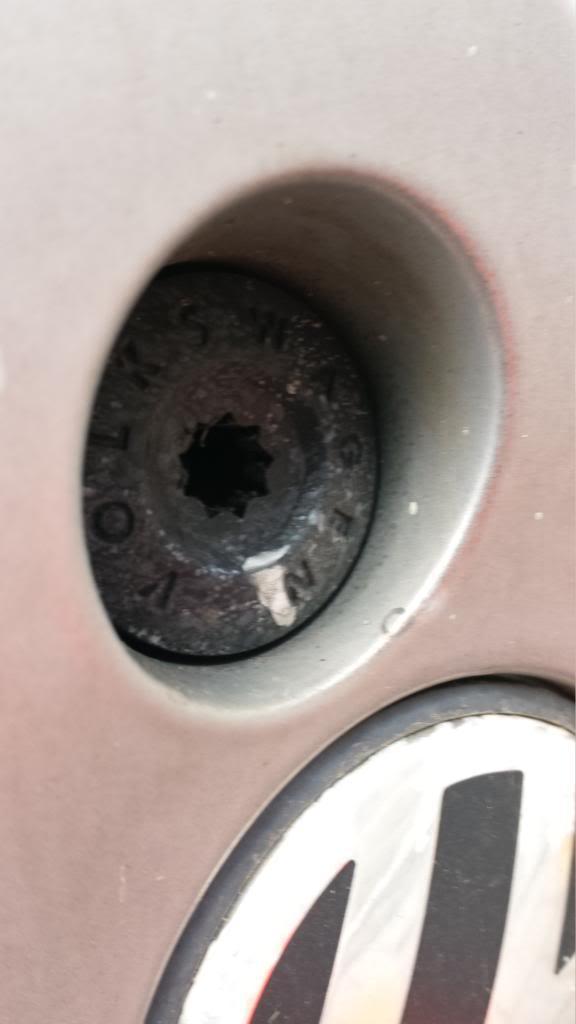

i cant figure out how to take my wheels off to a certain extent
I have these black covers/bolts, with a star shaped hole i tried all my star head/spline bits and none fit, so firstly do i need a vw key to remove them, and secondly is the actual wheel bolt behind these covers? I have a locking key in my boot that i assume will fit my bolts but i cant locate anything which will remove these covers
cheers in advance

You need to pull that cap off to reveal the actual wheel bolt.

thats what i thought, but how dose it come out? is it just pushed in? or screwed in? ive noticed most of them look pretty chewed up

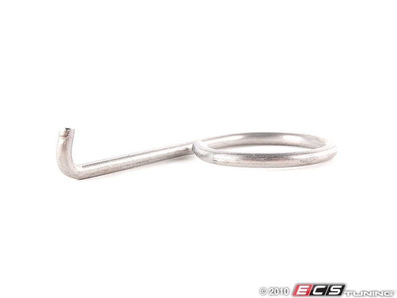

Just use a hook and they pull out.
Thats the correct tool

The tool Rich has shown you above should be in the Styrofoam in the spare wheel well along with your wheel lock key.
