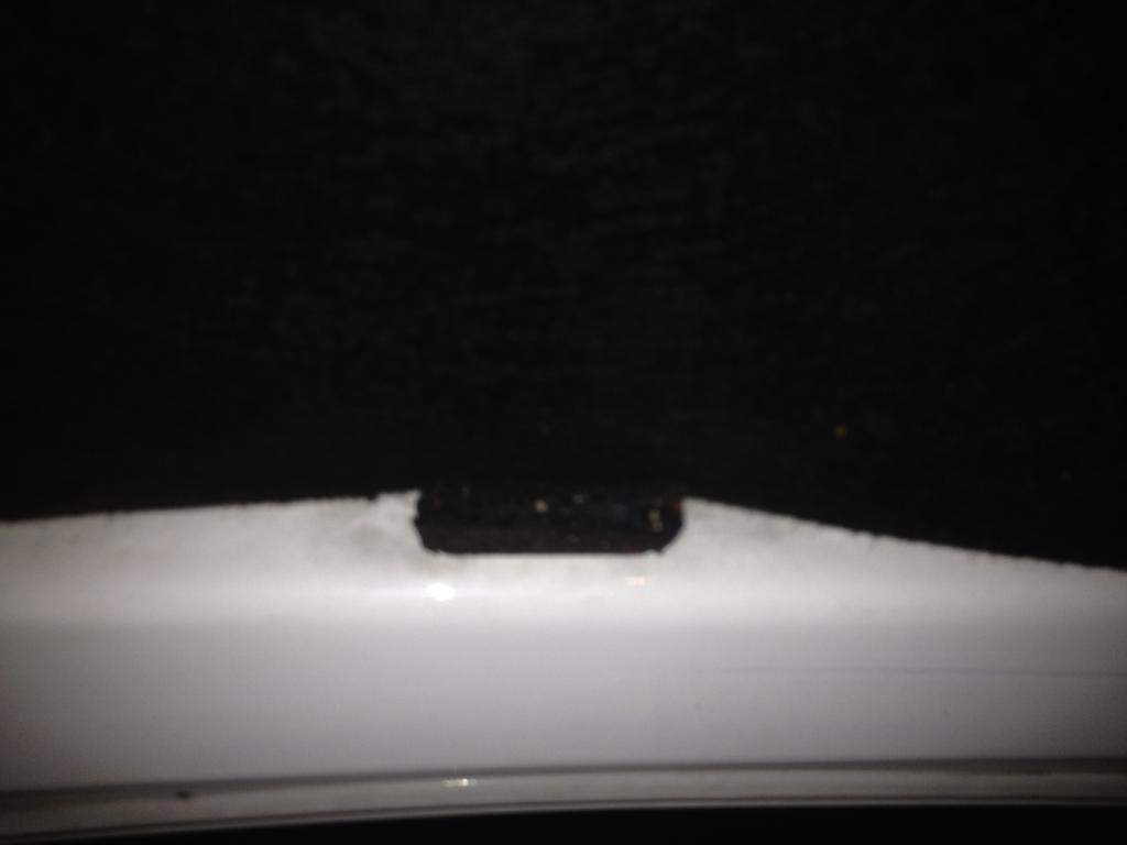

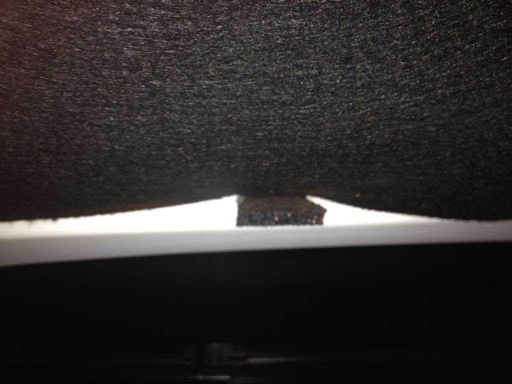

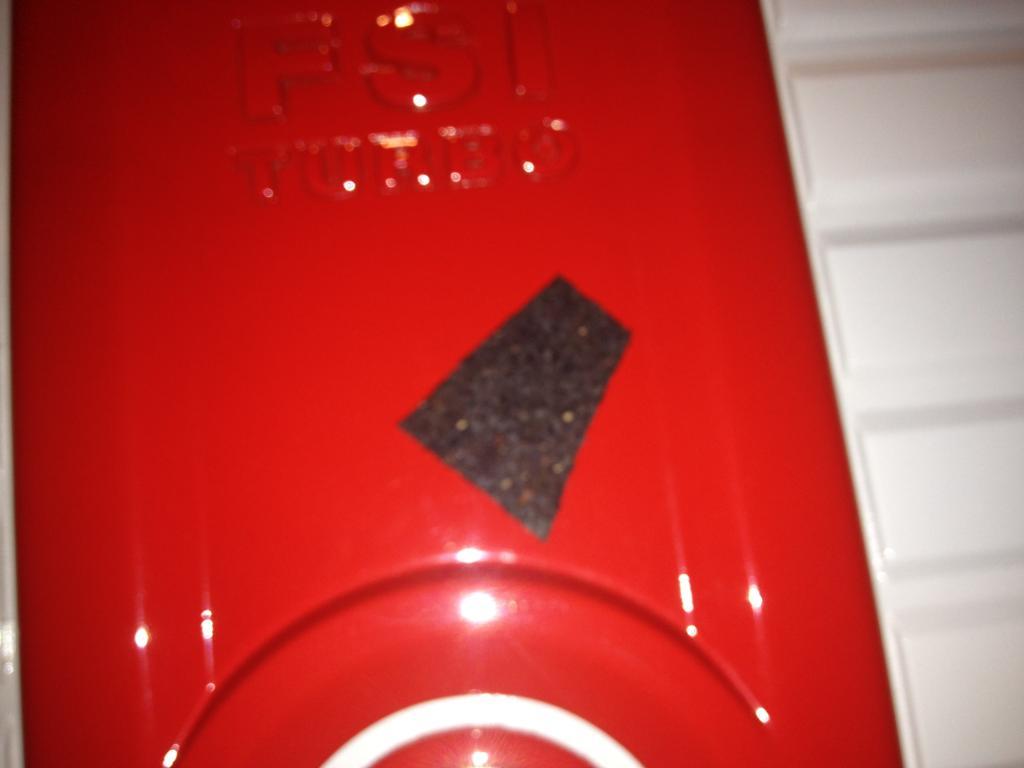

I made little wedges /___\  this shape out or rubber about 3-4 mm thick and used them to hold the tangs in their slots , wide enough at the wide end so they wont go all the way in
can get a pic tomorrow if you want one

this shape length isn't important width at the widest point is so is doesn't slip inside
this shape
half in and easy to remove
all the way in you can hardly see them
flash iPhone pics sorry best I can do tonight
Rob

That's awsome!!
What did you use to cut those wedges from ( rubber )
I'm trying to think lol  :stupid:
Offline Carpy25
  • Posts: 432
Re: Bonnet heat shield
« Reply #10 on: June 20, 2014, 10:41:39 pm »
some of mine a a rubber floor mat and others are foam that won't absorb water , but anything will work just make sure water won't soak in or that will cause rust in a few years
Rob
